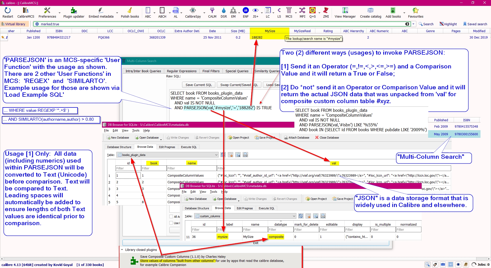

Version 1.0.80 Ability to search table books_plugin_data
Version 1.0.80 - 10 April 2020 Ability to search table books_plugin_data using new Raw SQL Query user function keyword "PARSEJSON".
See the attached image.
I have tested this in both Python 2 and Python 3.
DaltonST
BTW: the plugin that updates table books_plugin_data, SaveCompositeCustomColumns, will not compile as of this writing in Python 3 Calibre 4.99.4.

@DalsonST, after loading the new version of MCS 1.0.80, attempting to use PARSEJSON gives error "Raw SQL Query Fatal Error: SQLError: no such function parsejson'
Do I need to do something additional to get parsejson?
kcarscadden is offline   Reply With Quote
Spell it as instructed: PARSEJSON not parsejson.
Added: I will add automatic correction of PARSEJSON capitalization errors in the next version of MCS.
DaltonST

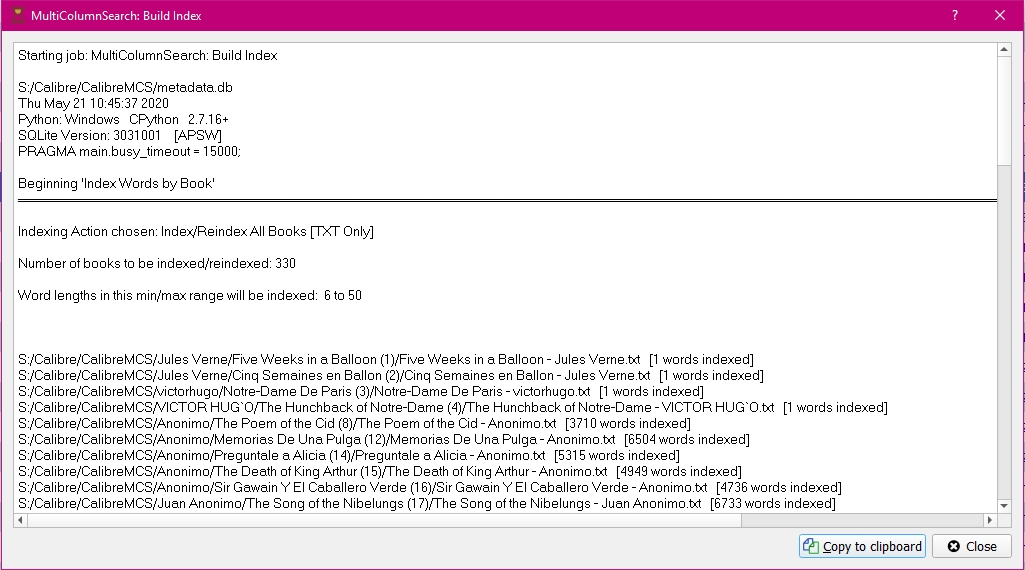

You need to post your entire Calibre MCS debug log. Run Calibre in debug mode, then recreate your error.
Also, post your Job Log of the indexing job that is causing this error.
This error is being caused by a callback from the indexing Job to MCS.
You said "Removing the search accelerators" did not work. That is only for permanently uninstalling MCS. To reinstall all search accelerators, reinstall MCS and then execute the MCS dialog to automatically reinstall them.
Added: The indexing job works perfectly for me. See the attached job log.
Where is your metadata.db? In the cloud? On a LAN?
DaltonST

Job: 0 MultiColumnSearch: Build Index finished
Starting job: MultiColumnSearch: Build Index
	D:/OneDrive/Buecher/Calibre Library/metadata.db
	Thu May 21 18:42:25 2020
	Python: Windows   CPython   2.7.16+
	SQLite Version: 3031001    [APSW]
	PRAGMA main.busy_timeout = 15000;
	Beginning 'Index Words by Book'
	Indexing Action chosen: Index All Unindexed Books [TXT Only]
	Number of books available to be indexed if needed and possible:    722
	Number of unindexed books that need to be indexed if possible: 5
	Word lengths in this min/max range will be indexed:  3 to 50
	Custom Column #mcs_was_indexed has been synchronized with the word-book index for non-MCS (i.e., user) index deletions or insertions, if any.
	Total number of books indexed: 0
	Total number of words indexed: 0
	Deleted Books or Invalid Books added via a CSV file, if any, have been removed from the Index.
	SQLError: unknown database _mcs_word_book_index
