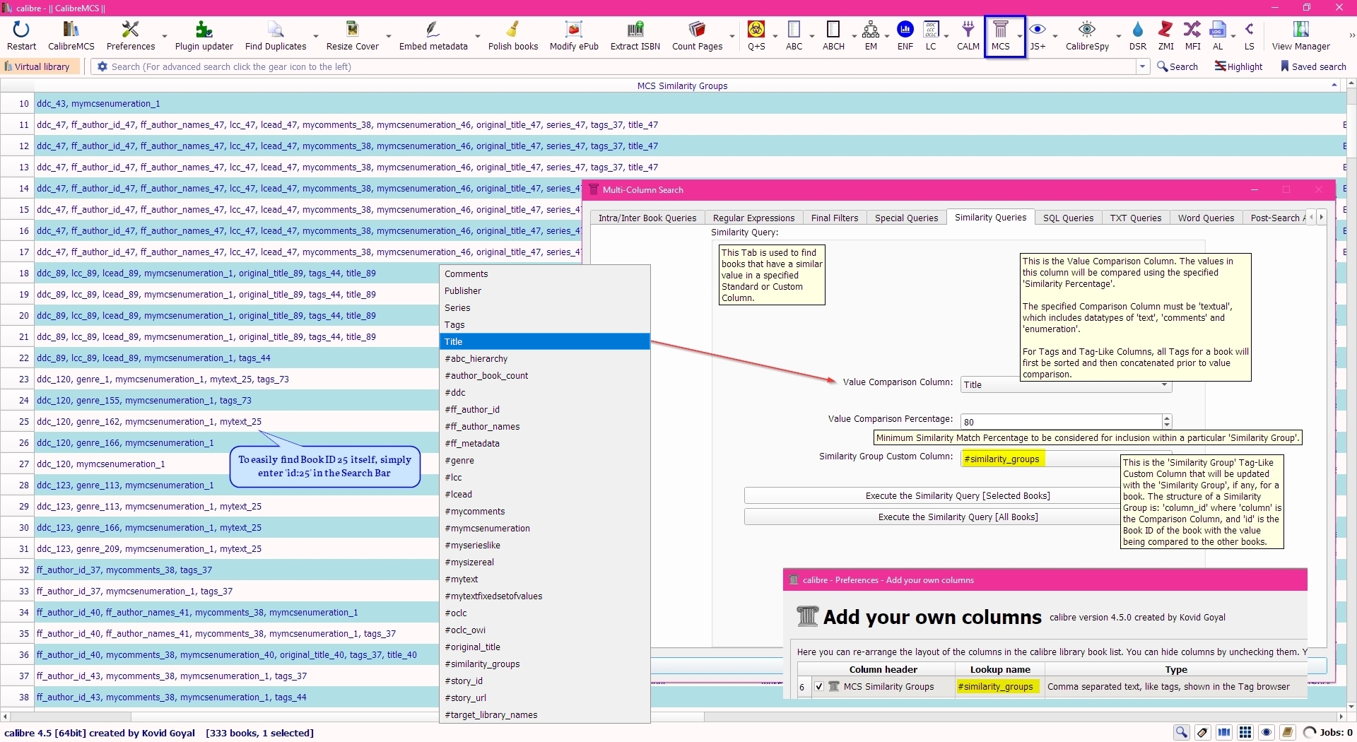

Version 1.0.76 - New: Similarity Queries Tab
Version 1.0.76 - 12 December 2019 Similarity Queries Tab.
See the attached image.
ToolTips are required reading; hover your mouse over each area of the window.

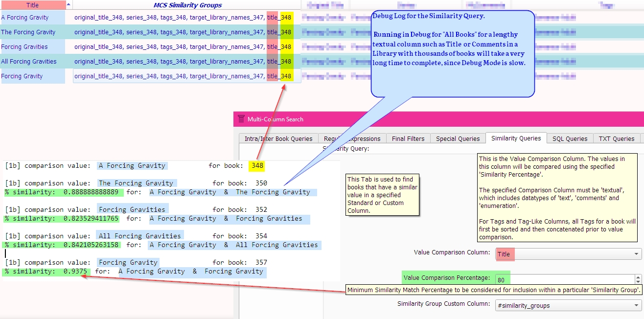

Similarity Queries
Originally Posted by Tanjamuse View Post
Thanks a lot. Could it perhaps be expanded so that it's more than just one column? Also what's the percentage for find duplicate's "similar" ?
[1] The unique similarity group ID custom column is tag-like, so there only needs to be one (1) of it. To compare multiple columns for each book, simply execute the query for each column sequentially. The image shows that many queries for different comparison value columns have already been executed, with the many unique similarity group IDs for each book, if any, so indicated.
[2] The Value Comparison Percentage specifies how similar a comparison value has to be for one book to another book for a specific comparison value from the specified comparison value column. 100% means "identical".
Attached is an example that includes the Debug Log.

At 88% it says Three Block South is the same as Three Block North for title.
Can you add author as well?

The titles differ only by the letters n, s, r, u. Raise the % and rerun, or ignore it. Human judgement is required.
