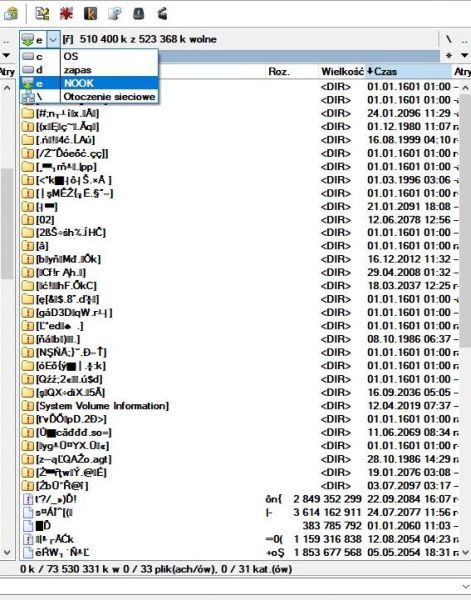

Then I found out about the author sort thing where it only counts several books by a single author as one book so now I'm not sure. I've had no problems since I stopped sorting by authors.
Unfortunately it's not a problem of sorting. It's mainly a problem of corruption of memory partition I suppose. Take a look on example of my Nook's memory after plugging into computer one day:

Yep. I think you're right that it's corruption.
