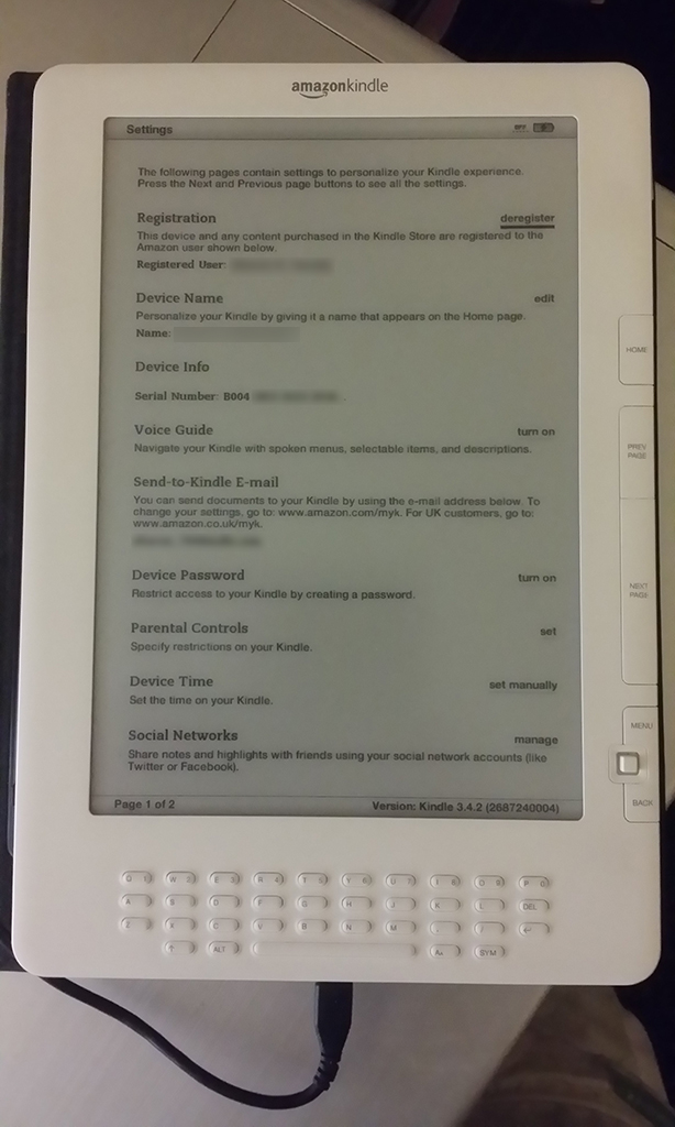

Success updating Kindle DX from 3.4 to 3.4.2
I updated my Kindle DX from version 3.4 to 3.4.2 this evening. (I used newman's guide at the top of this thread to successfully get to 3.4.). I've noticed a couple issues: 1) the Kindle freezes up sometimes coming out of sleep, and 2) it freezes everytime I try and run the browser. These issues may be due to the two patches whose updating proved problematic for me: libwebkit-1.0.so.2.5.0 and firmware.md5
I documented my steps in the hope that others have an easier time with this. They differ just a little from what newman already wrote. Please let me know if I could have done anything different or better (especially at steps 6-10). For those wanting to follow these steps, you'll need to have the USBNetwork hack functioning. I also found it super helpful to use cygwin and winscp (from my Windows environment). Thanks to everyone whose helpful write-ups and hacks made this possible!

9. I ran the update and experienced my first setback: a failure in patching mt-3/firmware.md5. There doesn't appear to be any mt-3 firmware to patch in the DX. See line 2108 of my-upgrade.err. (And here's my-upgrade.out for what it's worth.) The error:
bspatch: /opt/wan/firmware/mt-3/firmware.md5: No such file or directory
I wasn't clear on why it failed at this step. (Lack of memory? I increased the swapfile size from 64 to 256 and saw that the update failed in exactly the same place.) I commented out the firmware.md5 patching lines from 1725970040-2687240004.sh not feeling terribly confident that I was doing the right thing. (Any harm to commenting out those lines?)
10. I ran the update again and it failed at libwebkit-1.0.so.2.5.0. Per newman's guide, I performed the following steps:
A. copied out /usr/lib/libwebkit-1.0.so.2.5.0 from Kindle to my computer.
B. patched libwebkit-1.0.so.2.5.0 with bspatch using the relevant patch (no. 135) in update-patches.tar.gz
bspatch libwebkit-1.0.so.2.5.0 libwebkit-1.0.so.2.5.0.NEW 135.libwebkit-1.0.so.2.5.0.patch
C. determined what the new md5sum was for the newly patched libwebkit-1.0.so.2.5.0
md5sum libwebkit-1.0.so.2.5.0.patch.NEW
D. edited 1725970040-2687240004.sh to replace the old md5sum with the new md5sum for libwebkit-1.0.so.2.5.0 in the couple of lines it shows up there.
E. replaced the broken bspatch line in 1725970040-2687240004.sh with the following:
cp /mnt/us/libwebkit-1.0.so.2.5.0.NEW patch/usr/lib/libwebkit-1.0.so.2.5.0
F. as in STEP 5, verified 1725970040-2687240004.sh
G. copied the file to the Kindle's USB root (/mnt/base-us) and ran the update. Success!!
So I just want to thank newman for their initial write-up and their busybox attachment. I hope what I've detailed here is useful and not too pedantic -- please offer any corrections or improvements that you might see that might help others reading this.

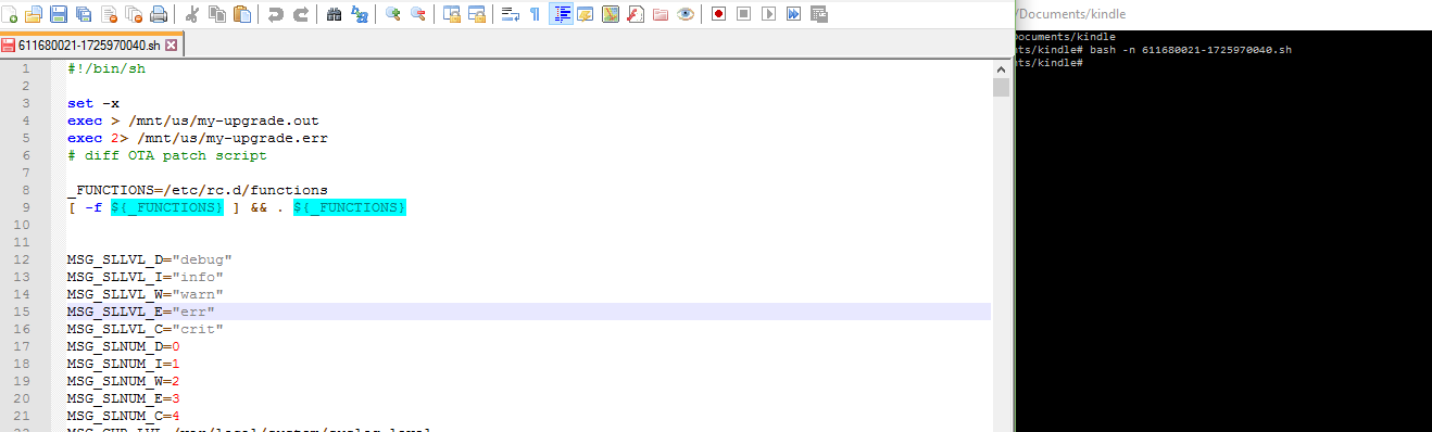

I'm having a bit of trouble trying to get the error output from the failed installation from 3.3 -> 3.4.
when i update, it fails but i dont get the error logs, like described in the guide. i dont think i edited the .sh file wrong when i checked it, it seemed to be fine (see pics), any idea what i could be doing wrong?
https://i.gyazo.com/68d1615cb39b34b1...701f1adbc9.png
EDIT: nvm, converted it to ansi (was in utf-8) and all is working now, now just need to figure out how to do all the swap stuff on windows
Last edited by mayofreak; 10-03-2016 at 01:17 AM. Reason: figured out my own problem
