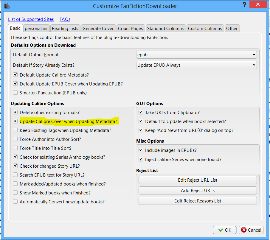

I have difficulties to get the images from Fanfiction.com to become the cover of my epubs. They do appear on the inside of the epub just fine - just not as "outside"-bookcover. How do I extract them? Do you need any further information?
Your help is appreciated! Thanks.

@firefoxxy and @tykobrian,
It's working fine for me.
Make sure that you have the 'Update Calibre cover from ebook' option turned on.
