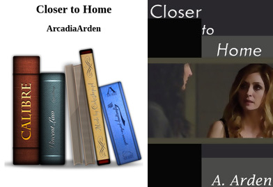

Exclamation Download book cover from fanfiction.net
I'm sorry if this has been discussed before but how can I download the original book covers along with the story from the site fanfiction.net? So far only the epub downloads but no cover page.

Unhappy
Well, if you'd read up the page a bit, you'd have found this posting that explains it.
Generate Cover doesn't matter for downloaded covers.
FYI, I plan to release a new version with that fix today if you don't want to figure out the manual plugin install.
Thanks for the help. I entered the lines in persona.ini and now a cover is provided with the ebook. But the thing is it's a custom cover, not the cover provided in the ffn site with the story. Please see the attached image.
Is it possible to download the original book cover which is provided in the site (ffn)using this plugin? I remember the site flagfic could attach the original cover back when they were allowed to download from ffn. Donno if they used this plugin though.
