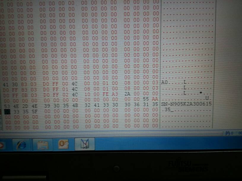

Hi guys, i'm here again with new doubts and questions (don't*be angry with me) but i won't make another damages.
Well, now i must write my kobo serial number in sd card image:
my details are
product: N905-KBO-S
SN: N905K2A300615-S
In order to*write my serial i've used HexEdit and i wrote only this digits after positioning at offset 200
K2A300615
Is it*all right or should i write any other informations?
Thanks and sorry for my bad english.
v!to

Old 05-03-2014, 04:33 AM   #219
davidfor
Posts: 24,905
Karma: 47303826
Location: Sydney, Australia
That looks right. Write the image to the card and you should be set to go.

Old 05-03-2014, 06:13 AM   #220
V!to
V!to began at the beginning.
Posts: 13
Join Date: May 2014
Location: Italy
Device: kobo touch N905C
Finally my ebook is working again!!!!
Thank you so much guys especially to davidfor for his patience with me
See you soon.
