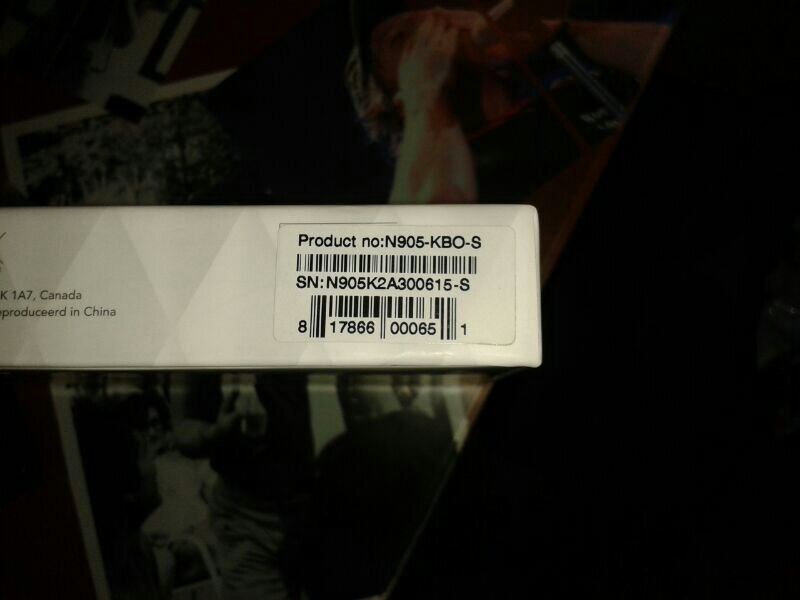

Hi guys, i'm here again with new doubts and questions (don't*be angry with me) but i won't make another damages.
Well, now i must write my kobo serial number in sd card image:
my details are
product: N905-KBO-S
SN: N905K2A300615-S
In order to*write my serial i've used HexEdit and i wrote only this digits after positioning at offset 200
K2A300615
Is it*all right or should i write any other informations?
Thanks and sorry for my bad english.
v!to

That looks right. Write the image to the card and you should be set to go.

Finally my ebook is working again!!!!
Thank you so much guys especially to davidfor for his patience with me
