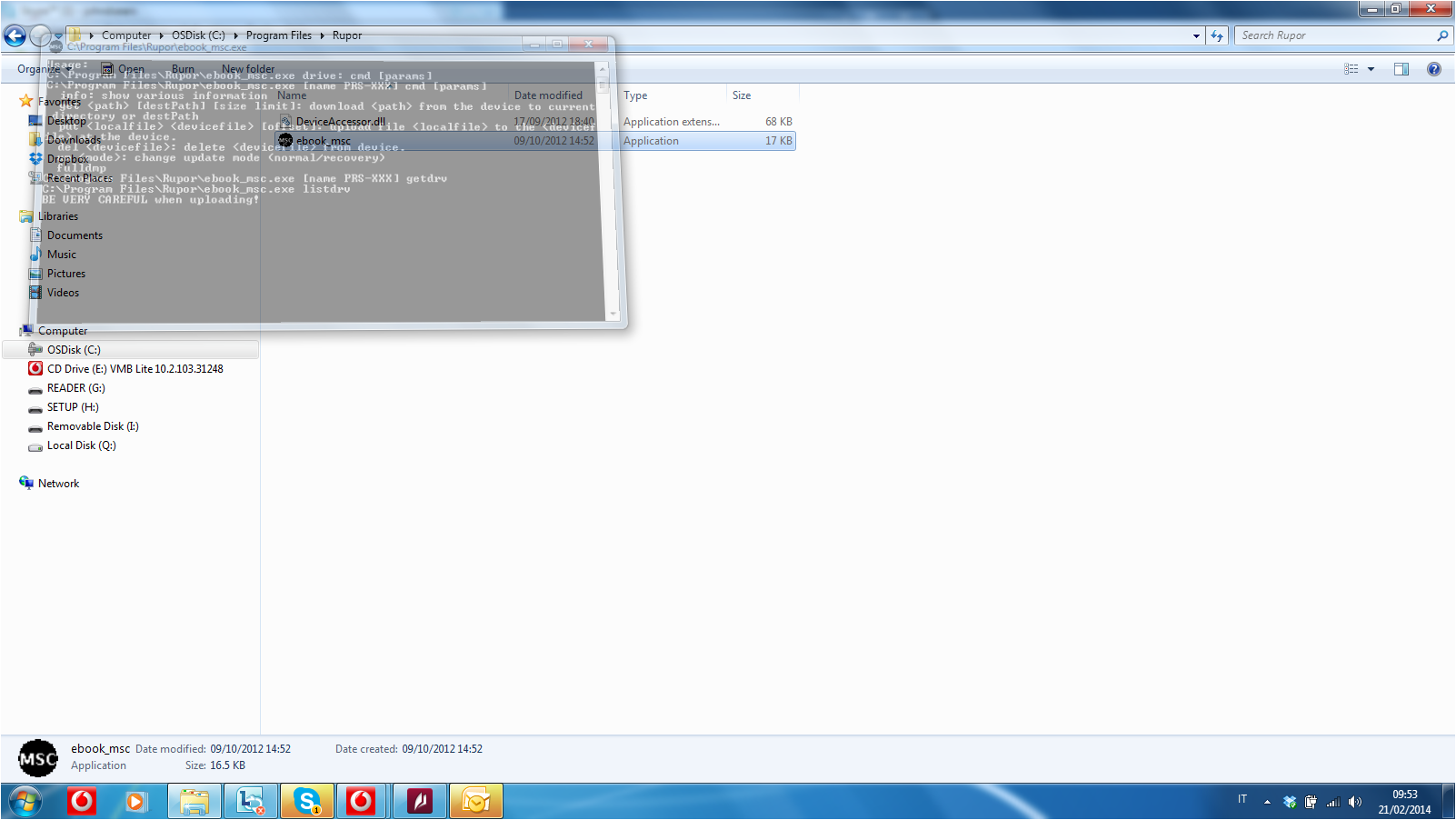

Old 02-21-2014, 04:07 PM   #215
johnthemate
johnthemate began at the beginning.
Posts: 5
Join Date: Jan 2014
Device: SONY PRS - T2
thanks so much for all the effort put in.. im trying to follow, but starting to think I must be an idiot.. give me a bit more time to see what is going on, do even more reading..
for eg..
Trying to run ebook_msc.exe straight from the pc, does not seen to do anything. dos type widow flashes up and then dissappears managed to screen shot it before it dissappeared.
I presume the after doing the procedure witht eh home and menu button that the reader should come off the opening book page.. anyway, I am sure that I am expecting to see a new image file ont eh SD card.. none of this is happening
back to tryign things.. so deperately want my extra dictionaries, and I cannot even tie my own laces yet!
Thanks
johnthemate is offline   Reply With Quote
Old 02-22-2014, 02:58 PM   #216
johnthemate
Posts: 5
Join Date: Jan 2014
yeaa! - making progress. Got the back up at last Thanks!!!
Yeeahhh x 2 - after initial phobia all worked like a dream. Thanks very much !! one happy hacked Sony owner. Thanks again!!!!
