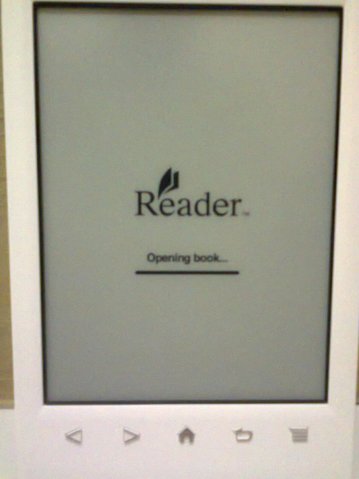

Failure reinstalling rupor AMR
To rupor, porkupan and all...
I have problems with my prs-t2.
At first, I really wish that my reader supports RTL (arabic, persian, etc).
So, I rooted the reader with rupor jailbreak, AMR, resize, dicts, etc.
They were successfully installed.
Then I installed FastDict (persian dictionary), but the reader still can't read RTL epub.
I have installed google play too, and every time I open it the reader shows message "stop work".
Finally, I un-rooted the reader by installing "restore-set-1.0.04.11081-us". And it was successfully.
Today I read an article about installing google play on prs-t2, by placing "G_Play_Store_v3.10.10_Modded" in "...\rupor-minimal\sdcard\updates\system\app".
So I follow the intruction. And I put FastDic too.
Before installing jailbreak, I formatted internal and external memory.
Then I installed jailbreak, and it was successfull.
Unfortunately, when I try to install rupor-minimal it has failed.
The reader can't start and can't be turned off.
Anyone can resolve the problem?
Thanks before.
I'm sorry, my english is very bad.

You where attempting to restore device with resized partitions - it is already wrong. You should use full backup/restore procedure instead. Than you were trying to apply changed AMR - do you know if system partition has enough space for your additions? Also - there is no need to re-install jailbreak multiple times, once is enough.
Here is what I would do (not sure if it will help): charge the device, use hard reset and try to boot into recovery mode. See if you could open terminal session into device. If successful - you will need to manually restore device partition by partition (use search - there examples here). Or try to restore full backup if you have one... All of that is difficult and dangerous for the device - but I guess you are not afraid

Thank you for the answer,
I have tried your procedure, but The device still not responding, stay saying "Opening book.." without end.
And the device can not shut down.
Oh my God...
fatoni is offline   Reply With Quote

Did you try the same procedure without SD card in the slot?

I tried, nothing happened...
Any way to shut it down? power button doesn't work.

I guess the problem is like .marine's reader, the screen freezes on "Opening book...".
