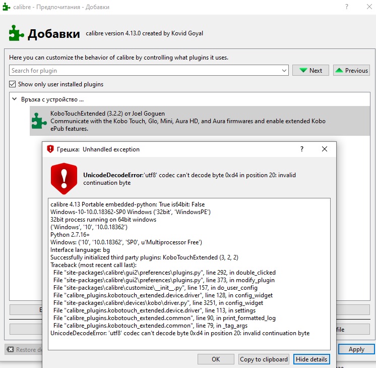

Of course, I restarted Calibrе. I even installed a brand new one (not a portable version). The result is the same.
Even after installing the Kobotouchextended (and restarting Calibre), the Kobotouchextended settings cannot be accessed I'm not even talking about connecting with Kobo.
I am attaching two screenshots after the installation of Кobotouchextended and a Calibre restart, without connecting it to the KAO.
Did you restart calibre after installing the plugin? This must be done for the plugin to work. If it doesn't, open the configuration, make a change and save it. You can reverse the change later. I can't think of a reason why not having the file would cause a problem. And testing here, I can't reproduce it this way, but, it will at least remove a possibility.

If it's a question for me - I have no special characters in the username. I tried on windows 7 - same error.
calibre 4.13 Portable embedded-python: True is64bit: False
Windows-7-6.1.7601-SP1 Windows ('32bit', 'WindowsPE')
32bit process running on 64bit windows
('Windows', '7', '6.1.7601')
Python 2.7.16+
Windows: ('7', '6.1.7601', 'SP1', u'Multiprocessor Free')
Interface language: bg
Successfully initialized third party plugins: KoboTouchExtended (3, 2, 2)
File "site-packages\calibre\gui2\preferences\plugins.py", line 292, in double_clicked
File "site-packages\calibre\gui2\preferences\plugins.py", line 373, in modify_plugin
File "site-packages\calibre\customize\__init__.py", line 157, in do_user_config
File "calibre_plugins.kobotouch_extended.device.driver" , line 128, in config_widget
File "site-packages\calibre\devices\kobo\driver.py", line 3251, in config_widget
File "calibre_plugins.kobotouch_extended.device.driver" , line 113, in settings
File "calibre_plugins.kobotouch_extended.common", line 90, in print_formatted_log
File "calibre_plugins.kobotouch_extended.common", line 79, in _tag_args
UnicodeDecodeError: 'utf8' codec can't decode byte 0xd4 in position 20: invalid continuation byte

I solved а problem I had with Kobo Touch Extended 3.2.2 add-on.
I've included the "Beta: Use Unicode UTF-8 for wordwide language support" option in "Language for non-Unicode programs" and everything works now.
First, I tried to choose English in "Regional settings" in "Non-Unicode programs", but that didn't work.
In general, if the Windows Display language is EN, there seems to be no problem.
However, I wonder why the problem occurred with the new version, while with version 3.1.5 there were no problems.
Thanks to all of you who engaged in my problem. I also hope my decision would help those of you who are dealing with the same issue.

I'm not surprised that the error also happened when you tried to open the configuration. I was sort of thinking that would happen when I suggested configuring the driver.
I can't think of why this is happening. @PeterT's suggestion about special characters in your username is about the only thing I can think of. But, I also woudn't expect that to be the case for a portable install. But, what directory are you installing calibre to?
I might be able to get a clue from a debug log. Could you run calibre in debug mode, repeat the above and post the log? Debug mode is started by right-clicking on the preferences button and choosing the option. Calibre will restart and display a message about debug mode. Do the above actions and then close calibre. It will then display the debug log. Post that, or PM it to me if your prefer.
  File "calibre_plugins.kobotouch_extended.device.driver", line 128, in config_widget
  File "calibre_plugins.kobotouch_extended.device.driver", line 113, in settings
