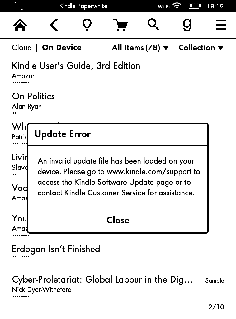

Old 06-27-2015, 03:17 AM   #1979
oumlaut
Omnia sunt communia
oumlaut has learned how to buy an e-book online
oumlaut's Avatar
Posts: 50
Karma: 84
Join Date: Mar 2013
Location: Izmir
Device: Kindle Oasis, Kindle Voyage, iPhone 7
Won't have any time to look into it until next Tuesday, but thanks for the heads up .
Thank you NiLuJe. 5.6.1.1 silently ignores kindle-jailbreak-1.14 and kindle-usbnet-0.18. Although I have the most up to date version of the JailBreak, I also gave the hotfix a try. The firmware issues an "Update Error". Let me know if I can be of any help.

Old 06-27-2015, 09:36 PM   #1980
NiLuJe
BLAM!
NiLuJe's Avatar
Posts: 13,507
Karma: 26047224
Location: Paris, France
Huh, that's a new bit of UI feedback...
