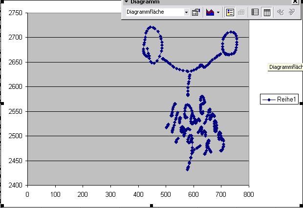

Edit:
Ok, it doesn't show the annotations in the reader. What a pity. I'll have a look at the additional annotation files.
Edit2:
Could you please show a photo of the annotations you made in the 3rd file?
i'd like to know what these columns in the .ink file mean.
Edit3:
Did it look somehow like this?
THat's the content in the .ink file, plotted.

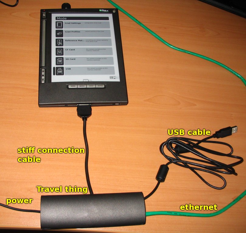

WOOO i got mine
Some things from me:
  • I love the box.
  • I does not contain any documentation besides a ~10x10cm mini leaflet.
  • I hate the cabling. Look at the attached picture. The travel thing is a mess. Reasons:
    1. the connection thing<->iliad is very very stiff, while the connector to the iliad is very very fragile.
    2. the case is 15cm wide, with a small box with the actual hardware underneath it, of size 6.5cm.
    3. cablings are sticking out to the left & right, so you can not have it dangling between your arms. this makes reading while recharging a mess. even if you read on a table with the travel thing placed on it, you first have to bend the connection cable, and then your arms are resting on the cables.
  • the travel thing makes it necessary to buy a (so far nonexistent) usb-to-iliad-connector cable if you want to access the iliad everywhere. so far, the software doesn't allow file operations (e.g., copy usb stick <-> internal memory)
  • wired ethernet is dhcp only, you cannot specify anything
  • reading scientific papers is not too much fun: I tried this paper (attention self-plug)
    1. letter/a4 with 10pt is next to unreadable
    2. render times are too long - flipping to page 2 of the abovementioned pdf takes 23 seconds (no joke, no decimal point forgotten). I guess I'll return to my idea of pre-rendered books.

Could you please draw a little bit in the test3.xeb and give me the resulting .ink file plus a photo of the screen? I believe it contains vector data about the stuff you have drawn.
Well, they should put in a note, where you can turn it on. And on the first power on, it should start the quickref automatically. But hey, maybe it will be done in the final version.
Yes, the connector gives me a few worries, especially since the cable is very stiff. The connector could be a bit more stable. They should take that into consideration with the next verison of hardware.
I already sent an email to irex regarding the network setup without dhcp. Ill post the answer, when i get it.
I posted an image of a cropped version of a paper. I found it to be readable, but not very easily. Although uncropped it is still readable, your eyes will probably pop out after a few sentences. I hope they put in a crop mechanism (standard zoom for all pages). The PDF Viewer is xpdf btw.
tribble is offline   Reply With Quote

Originally Posted by DHer
And when you are online atm:
Nope, I did something for myself. -- see attachment
the .ink really is just a sequence of stroke anchor points. I converted to ps via
#!/usr/bin/perl -w
print<<EOF;
%!PS-Adobe-3.0
%%BoundingBox: 0 0 595 841
%%PageMedia: a4
.2 .2 scale
EOF
$nstrokes=<STDIN>;
for(my $i=0; $i<$nstrokes; ++$i )
	 $npoints=<STDIN>;
	 for( my $j=0; $j<$npoints; ++$j )
		  ($x,$y)=split(/\s+/,<STDIN>);
		  if( $j==0 ) { print("$x $y moveto ") }
		  else { print("$x $y lineto "); };
	 print("stroke\n");
print("showpage\n");
The original picture was screen-filling, the extremely long protruding spikes must be some sampling error at the screen boundary.
