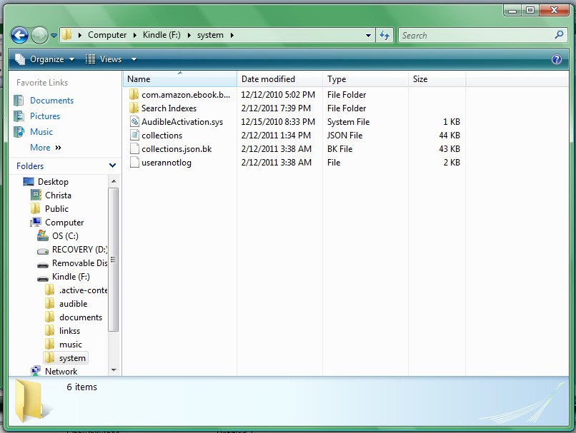

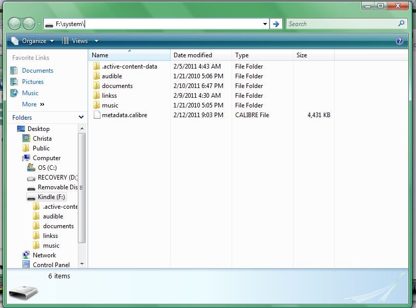

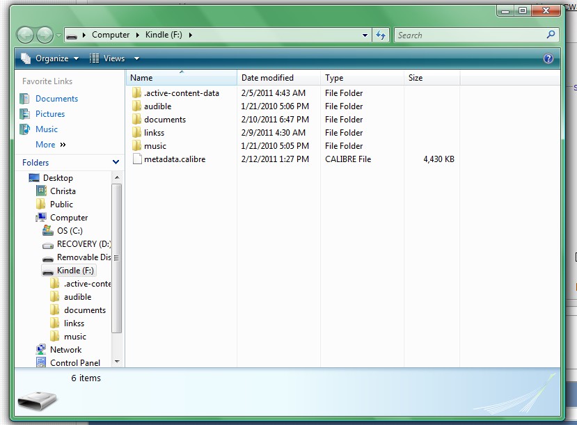

Originally Posted by Rie142 View Post
Looks like it works better for me now. I ran it in the debug mode. Now I would like to know where the collections.json file is located at. I have looked all over on my computer and on the Kindle. What am I missing. Can you help me find it so I can get rid of all the information of old books that it is holding? I am still getting a couple odd tags but not as bad as before.
It's in the "system" folder, which is hidden by default. In Windows, you can either change your folder preferences in Explorer to show hidden folders ("Organize" button in Vista>Folder and Search Options>View tab), or you can open the Kindle "drive" in Explorer, go up to the address bar, and simply add system\. For example, my Kindle is f:\. In Vista (and I guess Win7) it looks like you can't type in there but you can - just click in empty space in the Explorer address bar and it will change from "buttons" to a field you can type in. Screenshots attached.

At least on Vista, you also need to set it to show system folders since the 'system' folder is being seen as a system folder to Windows.

Talking

Thanks, I figured it out that the collections I was getting extra were already on my kindle. Everything is good now. Just a few books that aren't in collections for some reason. Probably just a miss placed tag. Won't take me long to clean up.
Thank you so much for all the help. This old dog is slowly learning how to do things. Just need to read slower so I don't miss things.
Ok I am off to try this. Yes I am running Vista. Seems to work fine as an OS for me. Now just need to find where it has the hidden folders. I will probably just add it to the explorer bar. I will make it work.
