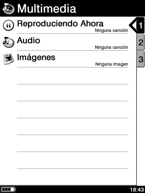

Originally Posted by surquizu View Post
Kartu, I installed the PRS + 2.0.10alpha in my prs-505., but the function Mark Books does not work (I have assigned keys on keyBindings). I think the kBookAssets.png file has no symbols (yes in prs-300).
The FB2toEpub converter works well with fb2 books sample in EbookApplication firm, but does not work (error message) with FB2 that there are in Spain (usually created with Book Designer or OOoFBtools). What software used you to create the FB2?
Is possible to recover the multimédia menu with the grouped options of Audio and Video?
thanks. good job

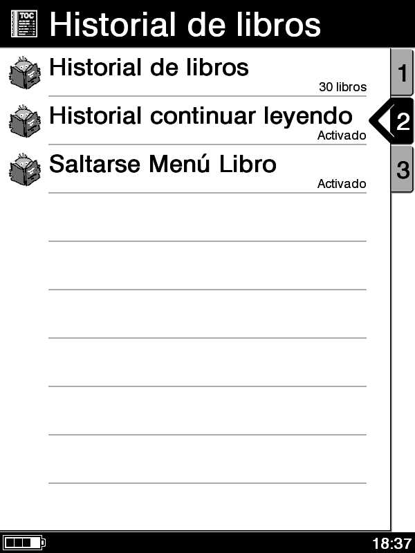

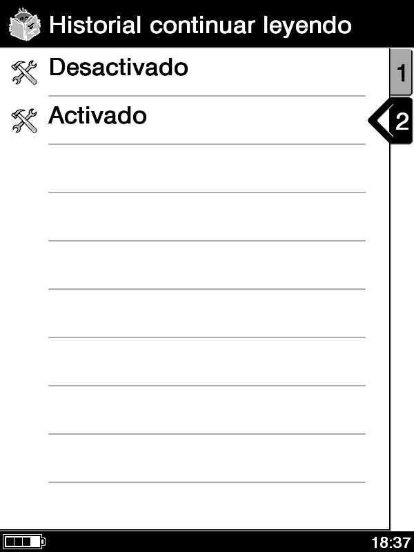

is it posible to implement the function of book history into continue reading like the before version?
Yes. I might also enable full menu customization via user.config.
Nah, this option is gone for good, but it could be possible to achieve the same with menu customizer.
Will have a look at gone "multimedia".
So in this case, a good solution would be create in menu customizer apart from continue reading and book history this is done, multimedia (now playing, pictures, songs), and continue reading with bookhistory incluide.
thanks
