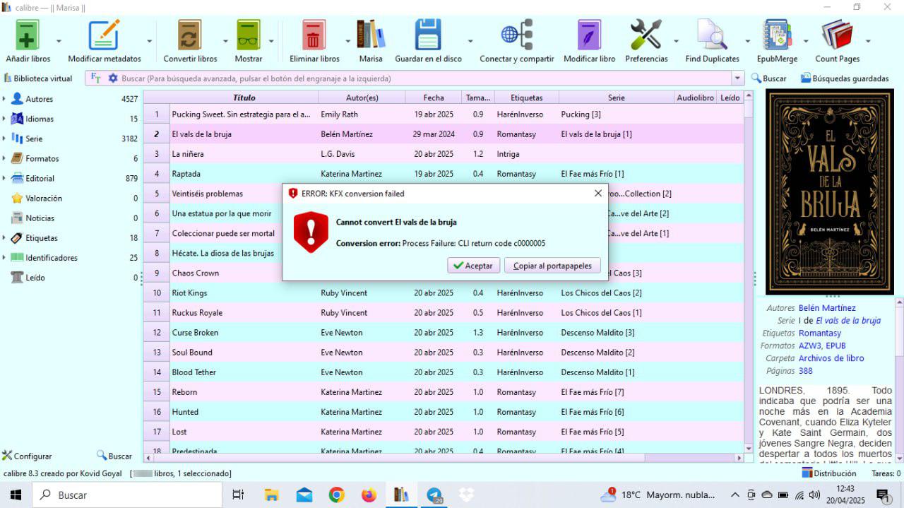

Many plugin users in my calibre group are reporting CLI errors c0000005 when converting an epub to kfx with Kindle Previewer 3 installed. What do you need to see this error or is it a known issue?
There have been occasional reports of this error, mostly from Linux users. I would need a conversation log and information about the platform being used in order to tell more about what is going wrong.
Windows 10, latest version of Calibre
Sorry, I don’t know what could be causing that.
