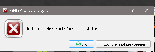

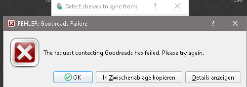

Exclamation My Goodreads Plugin wont work anymore.
I can't sync my shelf nor give calibre access to my Goodreads account. Is this because of an update? Is anybody else having this issue?
Attachment 192183
Attachment 192184
Attachment 192185
It is working here. It is most likely to be a network issue at your end or site problem. But, those screenshots do not tell me anything other than something didn't work. Press the details button to see the full error. And press the copy to clipboard button and post that for me to see.

Lightbulb
I just connected my Phone to my PC in order to transfer a book to my phone and now it is working just fine again. It is really strange. ive been having this issue for a couple of days now. Sometimes it sort itself out this time I had to connect my phone first...
Next time I will post the text on the "details" Button. Thank you for now.

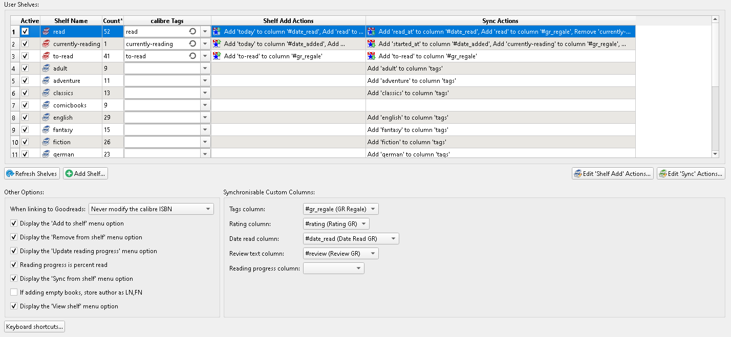

Exclamation Hey, how do I send Tags from my Calibre Books to my Goodreads Libary?
I made a couple of Tags in Goodreads today, in order to sort my books better. So whenever I read a Book I go to GR and put it in the "Currently Reading" Shelf and add the Tags. When I am at my PC i just sync my Library and the tags are added to my books which works great. However Ive been struggling to implement it the other way around. When I edit the Metadata of a Books to add tags in Calibre the linked Book in GR wont get tagged.
I hope you understand what I mean. Hope it is okay that I post this question here.
This is how I tried to do it but it doesn't work this way.

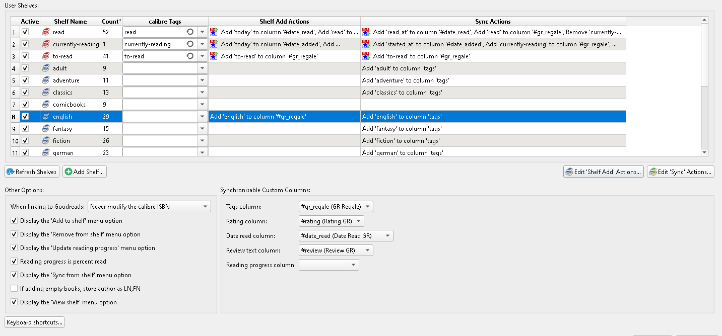

I made a couple tags in GR today, in order to sort my books better. Whenever I read a new Book I go to GR put it in the "currently-reading" Shelf and add the tags. Afterwards I just have to sync my Calibre Library and the tags that I added in GR are being send to the metadata of my Calibre Books.
However I am struggling to make this work the other way around. I cant add the tags in Calibre directly so that they will be added in GR. I tried it the following way but this doesnt work sadly. Any ideas? Hope its okay to ask this here.
This is how I tried to make it work
You can see the tags in Calibre but not in GR
Edit: Oh man I accidentally posted this twice sry. I thought it didn't work the first time.

The shelf and sync actions are for actions to take in calibre when adding a book to a GR shelf, or using the "Sync from shelf" function.
To put a book on a GR shelf, you use the "Add to shelf" function. Then you select the shelves from the list on the left and press the add button. The books should be added to the select shelves on GR and the add actions for each shelf will be done.
You can also use the "Linked Book->Upload tags as shelves". This will add the books to the shelves on GR that match the tag. And it should create the shelves if they do not exist.
The shelves "read", "currently-reading" and "to-read" are special. They will exist for all users. A book can only appear in one of these.
Thank you for your help.
I was also able to fix the Problem that CR couldnt access GR. Turns out my PC is so old that the little battery inside my PC for the clock was empty which caused the Time to be wrong. I replaced the battery and now it works fine.
LosNacho is offline   Reply With Quote
