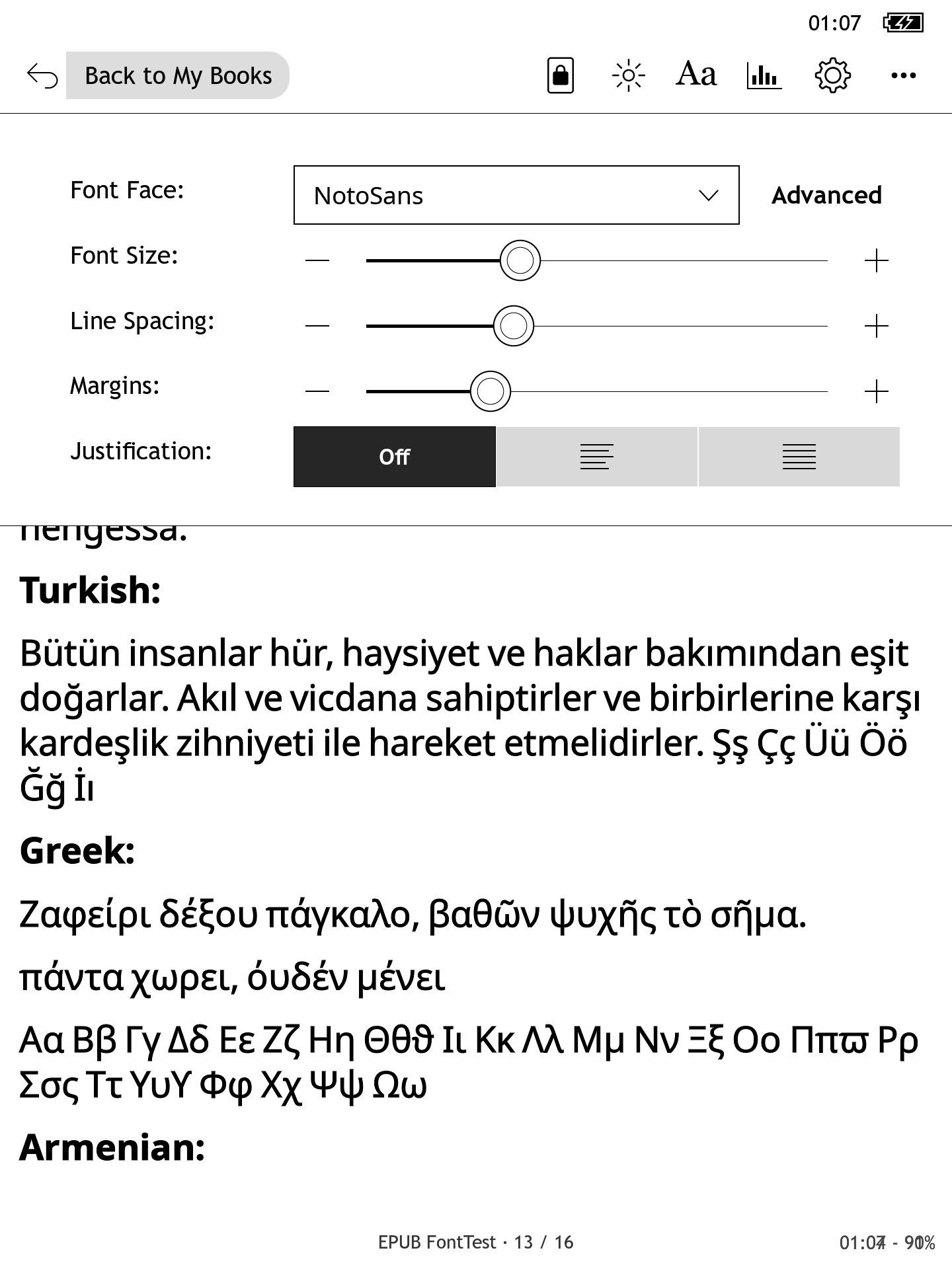

JackieW wrote,"Another thing to be aware of is that Georgia is one of the fonts used for fallback if the user's chosen font doesn't contain a particular special glyph."
An aspect of this puzzles me. I read my books as Kepubs, and I have sideloaded the font Noto Sans, which, with my astigmatism, is the easiest font I've fond to read in.
Noto Sans contains a huge variety of glyphs -- indeed, the name "Noto" is short for "No Tofu," with "tofu" being the term for the little empty box or question mark you sometimes see on websites.
And YET, even when using Noto Sans, my Kobo Clara HD still substitutes from, it looks like, Georgia (and certainly from a serif font) for many non-Western-Eurpoean accented characters (like those found in Turkish names, for instance).
I assume this means that somewhere in its software, Kobo consults a table of characters that it assumes will be missing and then substitutes EVEN IF THE CHARACTER IS IN THE CHOSEN FONT.

Just to be clear, do you mean missing Turkish chars when reading a book using NotoSans, i.e. nothing to do with Kobo GUI book lists containing Turkish names when the locale is set to Turkish?
If so can you give a couple of examples of chars which are "misbehaving"? This is a screencap using NotoSans with a bit of Turkish, including some special (I think) Turkish chars. This book's language is set as English.
I'm curious, since the UI looks a little weird to me, do you have any information on what UI modifications you use, like for the UI font and running header? (Otherwise, I could try to find those myself)
I make heavy use of the kobopatch system to customise the GUI. In addition I've replaced the 2 main system GUI fonts (Georgia, Avenir) with "better" fonts which are more to my liking (for various reasons).
However, none of this should affect what Turkish characters look like in a book when a sideloaded NotoSans font is selected. My screenshot shows no sign that any of the Turkish characters have used a fallback font rather than NotoSans.
