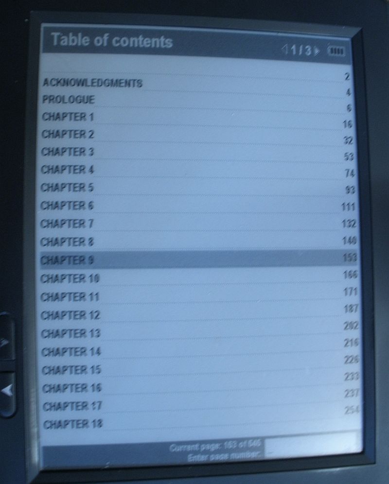

Ahhh, it sounds like you are making an in-line TOC? I have never used that capability because I never did like a TOC placed at the beginning of the book. I use the "Table of Contents" that CoolReader automatically creates from the chapter titles. I just use a very simple TOC, but CR3 will include anything that is marked with the <title> tag. The key that brings up the look aside TOC is CoolReader's "Go to page dialog key" that I have assigned to "3" in my case.
