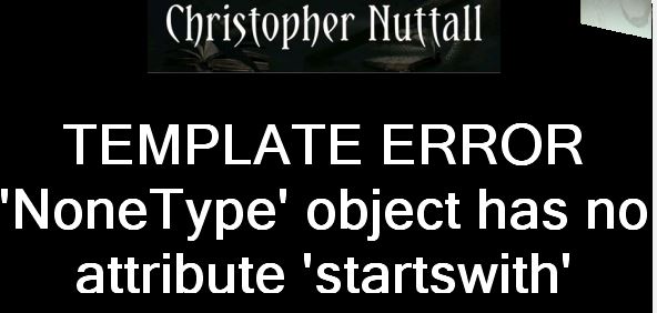

You took a 5 and a half year old thread and decided to tack on new questions that didn't exist in the original thread? Next time consider starting a new thread.
That said, it does appear that the font size control in Preferences - Look and Feel - Cover Browser - Template editor does not work. I would also have thought selecting a font size of zero would have eliminated the caption.
Find out how to report a bug or ask for an enhancement or new feature on this page.
Old 02-21-2016, 10:25 PM   #13
Posts: 31,902
Karma: 64184592
Dr Oh
You are correct.
I set a template, so I got the Apply button Changing the font size, does not trigger an 'Apply"
BUT if you crank up the size, it changes the size of the TEMPLATE not the target
AND
I just tried removing the template <image>
