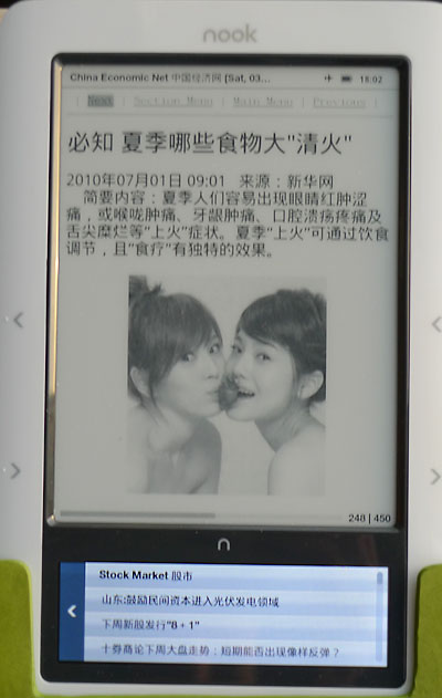

Recipe for China Economic Net Magazine
Tested OK B&N Nook
Language: Chinese (Simplified)
File Type: zip China Econmic Net Magzazine.zip (971 Bytes, 313 views)
