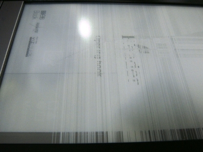

I bought my ereader in December and it has been working fine. About 4 weeks ago I was reading from my ereader in bed. When I tried to turn it off it wouldn't and the screen display distorted and had thin white lines horizontally across the middle of the screen, like a bar code. The power light was flashing yellow and I couldn't turn it off o access anything on the ereader.
As it is under guarantee I sent it to Sony Central Service in Bridgend who sent me a bill for £216.82 saying that there was physical damage which isn't covered under the guarantee. To cut a long story short I disputed the physical damage and was put through to Sony customer service who investigated. They contacted me today to say they had received a photo of the damage from Bridgend and 'that the only way these lines can appear on a screen is following physical damage'.
I have attached the photo that Bridgend sent which shows the screen, can anyone help please?
I need to get back to Sony in the next few days, either way I'm still going to have to pay £27.50 for a refusal to repair!
Have you heard of this happening before? Is Sony correct, that this only happens following physical damage? I know that nothing happened to the ereader, if I had damaged it I would have just claimed on my house insurance, that's what I have insurance for.

seen that screen before, usually dropping it causes it. Think someone had one get squished in a backpack not too long ago causing a similar look

That's an absolutely classic picture of a broken screen substrate. It is caused by a physical break in the thin glass layer that lies under the outer screen. I'm afraid it's not covered by warranty. What Sony have told you is absolutely correct.

It IS physical damage. Broken substrate.
That's the disadvantage of e-ink, those fragil, thin layers of glass. You might have put too much pressure on the top, etc... It isn't covered by the warranty.
Get a case.

Something might of gotten on the reader's screen. A cat, a dog, etc. Something might of fell on it.
It's unlikely it's a defective screen, it's much more likely it was a freak accident.
