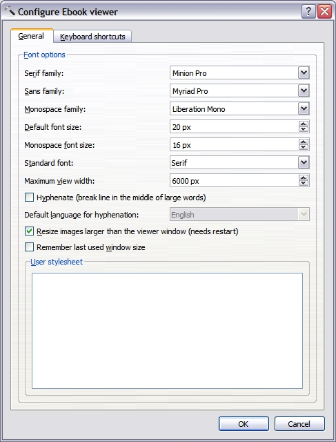

Usually I'm the one who can shout in a loud and confident voice "Man, am I ever doing this wrong!" So, here goes. WinXPsp3, calibre uninstalled and reinstalled at 7.1, upgraded yesterday to 7.2.
Attached: Lots of things:
MinionMyriad-source.zip - actual source before calibre 7.2, created in Word 2007, cleaned up in Dreamweaver cs4 and converted to xhtml. Word quickstyles match (close enough, anyway) to the styles.css. Xhtml and css are close to validating - couple lines here and there about colors in hyperlinks and it's there.
Clipboard01.jpg - a picture in firefox showing the top of that source with the ligatures properly in the correct fonts, Minion Pro and MyriadPro-BlackSemiExt.
Basic Set - Brewt Himself.zip - the source zip file created by calibre.
MyriadMinion3_plugin.zip - calibre plugin that embeds fonts in epubs, based on source by Paul Tomashevskyi posted in the sticky "How to Embed Fonts After Calibre" on this forum. Fonts sourced out of C:\Program Files\Calibre2\resources\fonts\MinionMyriad
fontencrypt.zip - font encryption python script written by 'Paul Durrant' posted in the thread "fontencrypt.py - Add Adobe encryption to fonts in ePub" in this forum. I am running it separately; haven't succeeded in making it a plugin yet.
BasicSet.epub - epub created by calibre with embedded fonts embeddeed by above plugin and encrypted by above python script. [Keep ligatures] checked in conversion. Results below are the same before and after encryption.
So. I can see the fonts embedded with ligatures in ADE, minion.
I don't see the ligatures, but it looks like the headline font in ade.
I can see the ligatures in Calibre viewer, minion, but only if I set the default font to minion.
I don't see the ligatures in calibre nor the correct font (myriad) in the headlines, even if I default the sans font to myriad.
No overriding css in viewer.
I see neither the ligatures nor the fonts in B&N/pc.
So. Obviously, I'm doing things, lots of things, wrong because it almost works, but only sometimes. Have at me.

As I thought, you've run into encoding issues. 'BasicSet-12.htm' shows no ligatures at all in Firefox, and looking at it with a hex editor shows that your ligatures have been transformed into garbled 3-byte UCS-2 surrogates.
I can only recommend that you follow the advice I gave yesterday and use explicit escape codes rather than trying to paste in characters and hope they remain intact across all those hops.

Originally Posted by brewt View Post
st
is an example of the mangled 3-byte code (EFAC86) that has resulted from something in your chain mis-interpreting the 2-byte FB06 code for the st ligature and attempting to convert it. Hard to say if that's Word or Dreamweaver, but Word seems to produce html with the correct escape sequence for a private-use character. It seems calibre has somehow managed to separate this code back into the letters s and t, but can't do the same for the other mangled codes.
Ligatures (like swash caps, text figures and other typographic variants) are not part of the UTF spec* and you can't rely on programs to recognise such font-specific alternative characters. If you want to use them, make sure they're embedded as explicit escape sequences from the start.
*[Edit]Unlike useful stuff like Linear B (which died out around 1100B.C.) and 38 different types of arrow... The lack of UTF codes for text figures is especially annoying.
 are not part of the UTF spec and you can't rely on programs to recognise such font-specific alternative characters.
Ah. Makes sense - finally - thanks. So much for that idea.
