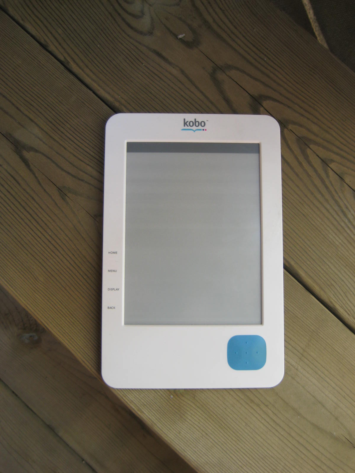

Hi guys!
Firstly I appologise in advance if there is already a topic on this, I could only find topics on your regular "frozen" and not what my Kobo is doing.
Basically I took it out to read on my walk to the station this morning and when I turned it on this is what happened:
http://twitpic.com/1vd5yl
When I turn it on I can see it trying to update the eink but it doesn't work. Then after the time it usually takes for the Kobo to start up I can hit the middle key to select my book and see as it tries to load that. I know the batteries not dead because it seems to be computing fine, it's just the screen that's f'ed and it doesn't change when it's plugged in. I've tried to turn it on again a few times throughout the day in the hope that it just needed some downtime and would fix itself, but no such luck.
I showed the people at Borders on my way home from work and they said it looked like a firmware issue and to call to support line. I just tried to call and they said the line shut at 4pm, which is a ridiculously early time to close a support line!
Since it's apparently an issue that they can talk me through fixing over the phone anyway I was hoping someone here might be able to help me out. I'm working tomorrow morning then going to the movies with my partner and I don't want to spend all weekend without my Kobo. I was just starting to get into The Girl with the Dragon Tattoo and everything. Sadface.

I've only ever see such jagged lines on image display on physically damaged LCD's and eInk panels. IMHO it is almost impossible that it is a firmware issue.
Most likely you have a crack on the panel, that may not be visible on the surface.
To me it seems the staff at Borders honestly don't have a clue at what they are talking about, which in this case may be a good thing. Good because you can probably convince them to exchange it, where physical damage is usually not covered under warranty.

I used to deal with LCD warranties and that was my first thought as well. I've been VERY careful with it though and I have no idea what could have happened to cause any physical damage to the screen. I didn't have it in a bag walking around and then I pulled it out and it had stopped working, it was sitting there untouched between the time it worked and the time it was broken.
I've looked at some photos of cracked eInk screens online and I think you're right; I think that's the problem.
Is it at all possible that the screen was damaged during shipment and has been bumped too hard and only showed itself now or somesuch?

Without any damage to the packaging box, ill say its unlikely.
From the looks of it it seems to have multiple fracture points without any surface damage, so twisting is probably your cause. Its possible when it was assembled it was already stressed, and a little knock pushed it past its elastic limit.
But thats just a guess.

frozen too
Same thing happened to mine. I've had it for a little over a month, and a call to Kobo had me trying to charge it again (although that wasn't the problem) and to stick a pin in the back (nope, nothing). They took my info and the next day I got a box and courier labels to return the device for a new one.
I hope this one works. I also wish I didn't return the Sony eReader I got for a gift after having bought myself the affordable Kobo.

You'll have a good case your screen is no way cracked, a connector or two has come loose and as long as your in warranty (1 year) and should have no problem.

I got my Kobo e-reader for christmas. In fact, it was my only christmas present (because we did a Kris Kringle thing this year with the family and all only got one christmas present).
I am devastated that when i turned on my Kobo today, it now is frozen/shattered or whatever has happened to the ink. The screen itself is not shattered. It hasn't been damaged. I've sent a request to Kobo so i will see what happens. I have hardly used it, and its just been sitting on my bedside table. It hasn't been dropped either.
