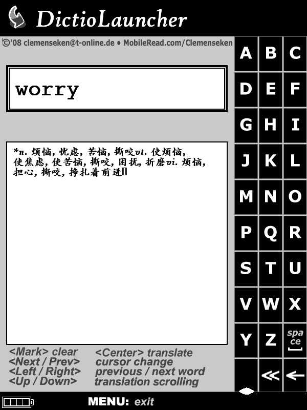

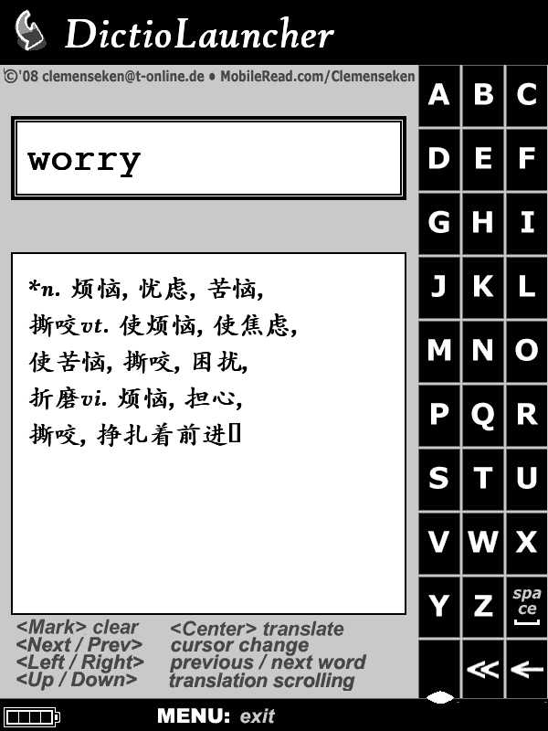

Originally Posted by m-land View Post
Reason is simple but solution - very dificult to do well.
Reason of this problem is that there is set limit of characters per line - and it is too much for chinese. It is set to 30 characters in 'old' version and to 40 characters for my 'small' version (see my previous post). See variable lineLength (if you run dictionary from SD it is easy to change)
BTW: I've personal plea. Do you perhaps have English/Chinese or Chinese/English dictionary in pinyin?
Thank you.I set the lineLength‘s value ,which is equal to 17,and the missing worlds can display now.BTW: I am sorry to say that I don't have any English/Chinese or Chinese/English dictionary in pinyin and I have searched all the internet and couldn't find any one. Sorry.

m-land
