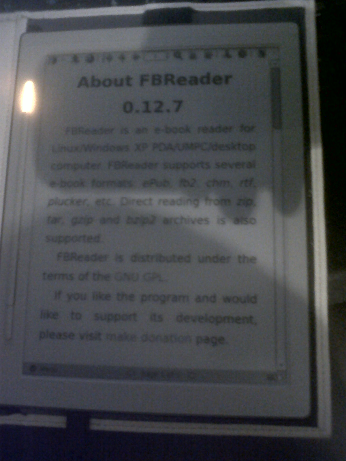

FBreader 0.12.2 in DR800S: missing libcurl
I've tried this version of FBreader in DR800S but I can't start because of a missing libcurl. Does DR1000 include it in base system?
Iņigo is offline   Reply With Quote

Sorry, I mixed versions; what I tried was 0.10.2 packed by Adam in this thread. Couldn't find libcurl.so.4. I've looked into the DR800 building env and it has libcurl.so.5. Copying it as libcurl.so.4 in FBReader lib dir didn't work either.
I also tried to compile 0.12.7 (last release) myself. In fact compiling was ok, after compiling and installing liblinebreak and libfribidi, but not linking.
It failed with lots of error messages regarding not found libc++ std functions. I've played with ld -L and -rpath flags some hours, but no luck by now.

FBReader 0.12.7 in DR800S working, but some work to be done
Well, I've achieved to make FBReader 0.12.7 work on DR800S.
There are some issues yet, such as the optimal default configuration, keystrokes, the toolbar options, etc.
I'm noting is quite slow as well, so maybe it would be better to try the old 0.10.x branch.
EDIT: confirmed, 0.10.x is very fast
Kind regards,
Iņigo
PS: excuse me for the bad quality of the image
