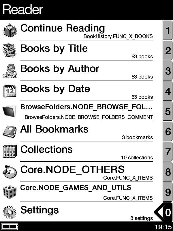

I have a question ,when i want to modify a scripts using your instruccions "builder installer", what have i to modify, only the scripts of scripts min too?
i've modified a scripts a lang scripts, but the result is this (for ex when is select spanish). Why is the reason?

[QUOTE = VICTORSJG; 903628]
He modificado un scripts scripts un lang, pero este es el resultado (por ej, cuando se seleccione español). ¿Por qué es la razón? [/ Quote]
This problem disappears when editing with JEdit + UTF-8.
