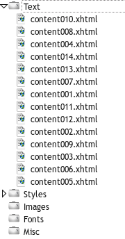

Well, random order is just random order. I used your macro twice with the same odt file, and obtained twice the same result when looking with Sigil without any processing (see attachment below)
I am not a CSS specialist too. I produced working EPUB with this, placed at the top of the CSS file.
Very strange… Using Sigil for Mac the files are listed in the correct order.
Even opening the epub file with winrar the order is correct.
Anyway, the file order is determined by the content.opf file, regardless of the name of the xhtml files…
I can't understand…

I had a try with a basic text, with one image and four footnotes.
I looked at the result on Sigil.We are not there yet.
+ the text is split according to TOC
+ a unique external and orderly stylesheet is created
+ processing is ultra-quick
- the text is split in random order
- the image is detected but not processed.
- the footnotes are detected. However, they are processed one by one, each footnote adding a split text part -in random order too-, instead of being put all together in a single footnote text part at the end of the book.
- the stylesheet has probably too many occurences of Georgia Garamond.
I still don't understand this point. The split is done sequentially from the begin of the file, and making a split every page break found. So, all the files are sequenced by name, by creation date and to zip adding.
I look it with Sigil, but in my files are in the right order…

Here are the odt file and your corresponding epub. I use OpenOffice.org 3.2 with Linux Ubuntu. I view the result with Sigil 0.2 RC1 Linux.
As I had reordered the text, I did a second trial and did not try to correct anything. Just to give you a raw result.
+ Good news, the image has been well processed!! I can't explain why it did not work the first time. Sorry for that.
All other remarks standing.
- I get consistently text xhtml blocks in random order.
