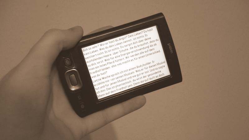

If the V1.8 don't work for you , you can try this snapshot version:
http://www.plkr.org/snaps
On my TX i have used plucker and it does support the 480x320 Mode with DIA down.
Take an look at this pic:
