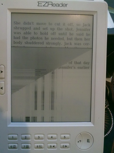

Strange thing happened to my PPro today.
I have not used my PPro during Saturday and Sunday. However, when I opened my PPro today, I noticed that the screen could not refresh properly . Only the bottom half was refreshing, and it was not even a good refresh. Moreover, there's part of the screen that was completely blank.
I attached a picture to show it to you.
I have tried the following steps to correct this problem with no success:
  1. Reset the device.
  2. Turn of the device and turn it back on.
  3. Pull out the battery for one minute, reinsert it and turn it on.
  4. Push the reset button for 10 seconds, hold it while pressing the power button on and release the reset button.
  5. Recharge it for 10 minutes to see if it's a battery problem.
The problem persist.
The only thing that I have not tried is to reflash it with the December firmware. I'm still charging it to ensure it have enough juice before reflash.
Additional information:
  1. The device was just recharged last week. It usually took 4 weeks to reduce it to 1 bar.
  2. I'm using December firmware.
Do you have any suggestion before I contact Astak? Thanks in advance!

Seems like screen broke, maybe did it fall or someone drop it on the floor?

Horizontal and or vertical bands are typical of an electrinics failure.
Never have seen a diagonal scan (and only for a portion) on a screen.
Was the unit subject to a shock or extreme temperatures?
I have, this link: http://comomcgyver.blogspot.com/2010...papyre-61.html (spanish) shows how is a v3/v5 screen thats broken and how he changed it by himself. Those lines make me suspect a posible broken screen.

I suspected broken
The local Fry's has a Broken Screen (V3) on display.
Every flat panel display I have serviced (many) tends to fail in segments (except for back light failures) unless physical damaged.
Color LCD's tend to "rainbow" near the impact point.

I think there is a chance the cable plugged into the ZIF socket isn't making full contact with all the points. A ZIF socket is a hinge that flips up and down and the cable inserts inside, then you close the hinge down over the cable.
Besides, there's no cracked glass on his display so..

Thanks for the replies.
The Pocket Pro was on my bookshelf the whole time, and has never been dropped or subject to pressure.
I was reading on Friday night and I put there myself. It has never been moved until this morning.
I noticed that if I pushed a button, then the lower half of the screen is refreshing as if it's changing pages. I guess I can rule out the battery problem.
Puzzled...

Searching for it now.
Originally Posted by hapmas77 View Post
@Chiron: Wow! that's a long time.
I purchased books from amazon from time to time and it usually arrived in 3 weeks. But that's normal shipping, not priority mail international parcel as Astak provide.
Anyway, Robertb asked me to PM him for my details. I hope this can clarify it.
To Robertb: Thanks! PM Sent.
Alvin.
Dear Alvin:
Delivery where you are can be a nightmare. We are trying to find out where the unit is and why it has not gotten through. Tracking where you are is god-awful also. This may take a little time to try to trace this out. I wish I had better news. We are calling some high contacts we have at USPS to get an update.
