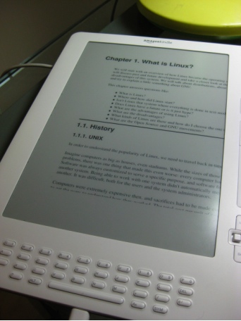

I have just ported muPDF to Kindle DX, in order to replace the crappy built-in PDF reader. Though still with some bugs and lack a GUI, it could correctly read and render PDF files - see the picture below.

Opps.... somehow the image was not uploaded...
