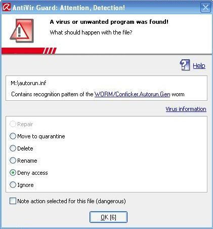

I had run the firmware upgrade after fully charging my new Pocket Pro. When I connected it to my computer's USB port my virus protection software popped up the alert attached, which reads:
M:\autorun.inf
Contains recognition pattern of the WORM/Conficker.Autorun.Gen worm.
In this case, drive "M" is the Astak Pocket Pro.
Have any of you encountered this before? I'm not too worried as my virus protection seems capable to manage it. I've disconnected, the reconnected the PP several times to confirm the sequence. The warning is triggered immediately upon clicking the menu button on the reader to connect to the PC. I tried using the "delete" option with my virus protection, and this may have removed the problem as I seem able to connect without triggering the alert.
I don't know enough about autorun.inf viruses to confidently assess what's going on here. And a bit of searching via Google and on this forum hasn't turned up anything either. I know that virus detection via pattern matching can return "false positives." I'm hoping someone more knowledgeable in this area might be able to provide some insight into the matter.

Can you delete the file? It is a virus that I have seen on my network at work. The file may be configured as read only. Once you remove that option delete it. Autorun.inf files typically contains some type of instructions so that when the CD or folder is open it will run those commands.

When I first got the warning, I just clicked "OK" to "Deny Access" to the file, as my experience with AntiVir has been that it cannot delete infected files when it first locates them. I usually check the log and delete them later or use a dedicated removal tool for that particular virus. I try to be careful so I don't run into this problem very often.
In this case I tried to view Drive M, which was the Astak's internal memory at the time as I had removed the SD card I used to flash the firmware at that point, so there is no question that it was not the memory card. However, I could not locate the file in question. I don't have any Linux distro's installed at the moment, so I don't know if I would have better look trying to view the memory of the reader using Linux, but in Windows XP I use folder settings where no files are hidden.
As I clumsily reported, I repeated the connect sequence several times to confirm that the reader was triggering the alert, but on the final instance tried the option from AntiVir to delete the file, and surprisingly it didn't offer it's normal "sorry--can't do that now" message and seemed to have deleted the file. I cannot say for certain it did, as I could never see autorun.inf in the first place. But ever since then I have been able to connect the device without receiving any warnings.
