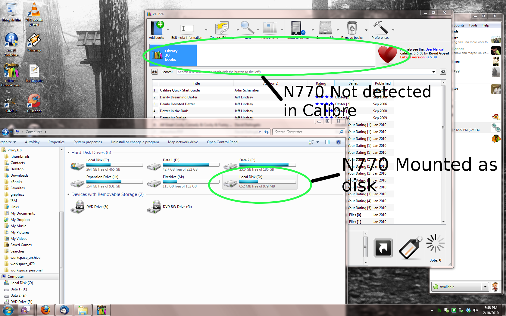

Old 02-10-2010, 07:54 PM   #8
proxy318
proxy318 began at the beginning.
Posts: 14
Device: Nokia 770
According to the debug output, it isn't.
The output is wrong. See attached image.
proxy318 is offline   Reply With Quote

Old 02-10-2010, 08:09 PM   #10
proxy318
Posts: 14
Device: Nokia 770
Also, when looking at the change log, I noticed this in version 0.6.34:
Switch to non WMI based method of detecting devices on windows
That's exactly the version it stopped recognizing the 770. Maybe the new detection method has issues with the 770?
Old 02-10-2010, 08:31 PM   #11
Posts: 45,669
Karma: 28549304
It has to be mounted as removable drive, which according to the debug output it isn't.
Revert back to 0.6.33, as I don't really see how this can be fixed.
