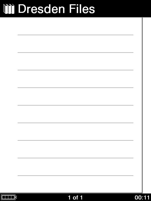

Old 02-22-2010, 01:15 AM   #836
DoctorOhh
US Navy, Retired
DoctorOhh's Avatar
Posts: 9,897
Karma: 13806776
Location: North Carolina
I deleted the book. But because the collection could not find the book, it locked. So really, moving is not a good idea unless it also handles removing the book from the collection as well.
I just finished reading the Dresden Files. After I finished each book I just deleted the book from the collection. I was able to open the collection each time with no problem.
I am now down to only one book remaining in the collection. I think if I remove this last book I might run into what you are referring to, trying to open a collection with no books in it.
Heck with it I'm going to delete it. Now the collection says No book. When I click on the Dresden Files with no books in it I get a collection opened with no books in it.
For the record I am currently using PRS+
Oh well another Sony PRS-505 mystery.
Update: just to be sure I shut my reader down then started it back up. I then went back into the empty Dresden Files collection without error.
