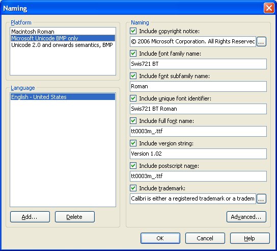

NOTE: Be sure when you rename the fonts that you also change the font sub-family on all three fonts is set to Roman. Spent most of the day trying to figure out why the flasher would work but then it would not restart.
If you are using FontCreator the names should be like this:
font family - Swis721 BT | Dutch801 Rm BT | Courier10 BT
font subfamily - Roman | Roman | Roman
full font name - Swis721 BT Roman | Dutch801 Rm BT Roman | Courier10 BT Roman
If you change the font subfamily to anything other than Roman, your Reader will hang at the Loading screen...

I'm trying to duplicate your font combination, since it looks awesome in Connect Software. I'm however having some problems in converting fonts with FontCreator.
I've renamed the fonts, changed all the fields in Format/Naming menu as per instructions above, but my fonts keep bricking the reader.
The length of my converted Cambria font, now renamed to Swiss is around 900K, which is considerately bigger than original.
Could you post detailed step-by-step instructions for font changes that have to be done in FontCreator or better yet, could you PM me the fonts, you created.

So far I've done the following:
1. opened font in FontDesigner (Calibri)
2. changed font naming to correctly set font family (Dutch801 Rm BT), font subfamily (Roman) and full font name (Dutch801 Rm BT Roman) for all character sets, that are supported
3. saved font as tt0011m_.ttf
4. copied fonts to Reader with Universal Flasher
So far my attempts were unsuccesfull and resulted in bricked reader.

I've attached the naming adjustments I made to the Calibri font, in case I've got something off there. If anyone spots an error, I'd appreciate knowing about it, 'cause I just ain't seein' it.
