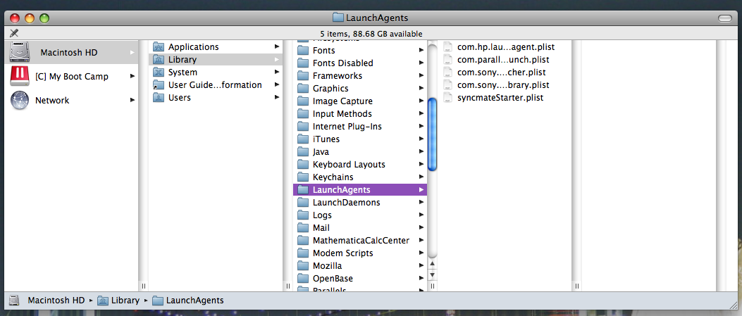

Have you tried deleting the launch agents for the Reader Library and reinstalling the software? See attached picture.
Thanks for the suggestion. I have tried this now and it made no difference.
