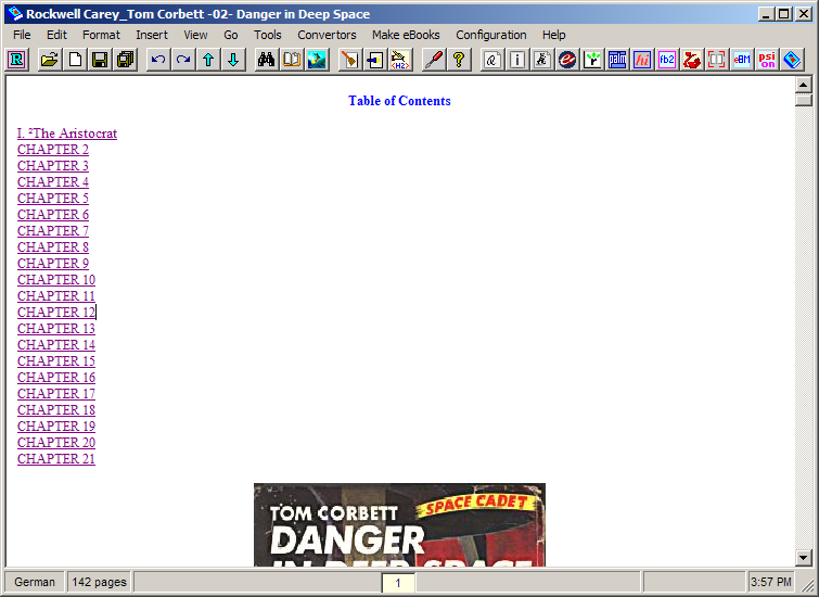

Here's a link to the htm file that exhibits the error.
http://www.babblebooks.com/BDbug/scaramouche.htm
the problem is the line:
<P><h3>II. ²The Aristocrat</h3>
(Ignore ² and anything else that looks odd, these are flags for later post-processing and don't affect the TOC issue.)
http://www.babblebooks.com/BDbug/toc1.jpg
1st screenshot shows how chapter II appears in TOC if Aristocrat is changed to "Arist°crat"
http://www.babblebooks.com/BDbug/toc2.jpg
2nd screenshot shows how chapter II drops out when changed back to "Aristocrat"; also shows Configuration/Settings window
Don't think that "Make Sony" can have any impact -- because the error manifests on load, before the target book type is selected.
Anais9000 is offline   Reply With Quote

Anais9000, I have some bad news for you.. it works. Here's the screen show to show it works. I am using the 05/30/2007 update if that helps.

Hi Jon,
Thanks for letting me know that there are some situations in which this bug does not manifest. That's true of all bugs.
Unless you think I'm photoshopping the jpg files, it's clear that in some situations the sequence "ocr" will cause a string to be excluded from the candidate-set of chapter titles. It makes no difference to me that this occurs, since I preprocess the occurences of "ocr" and post-process them within BD. I'm simply trying to help vvv reproduce the bug for the benefit of other BD users.
