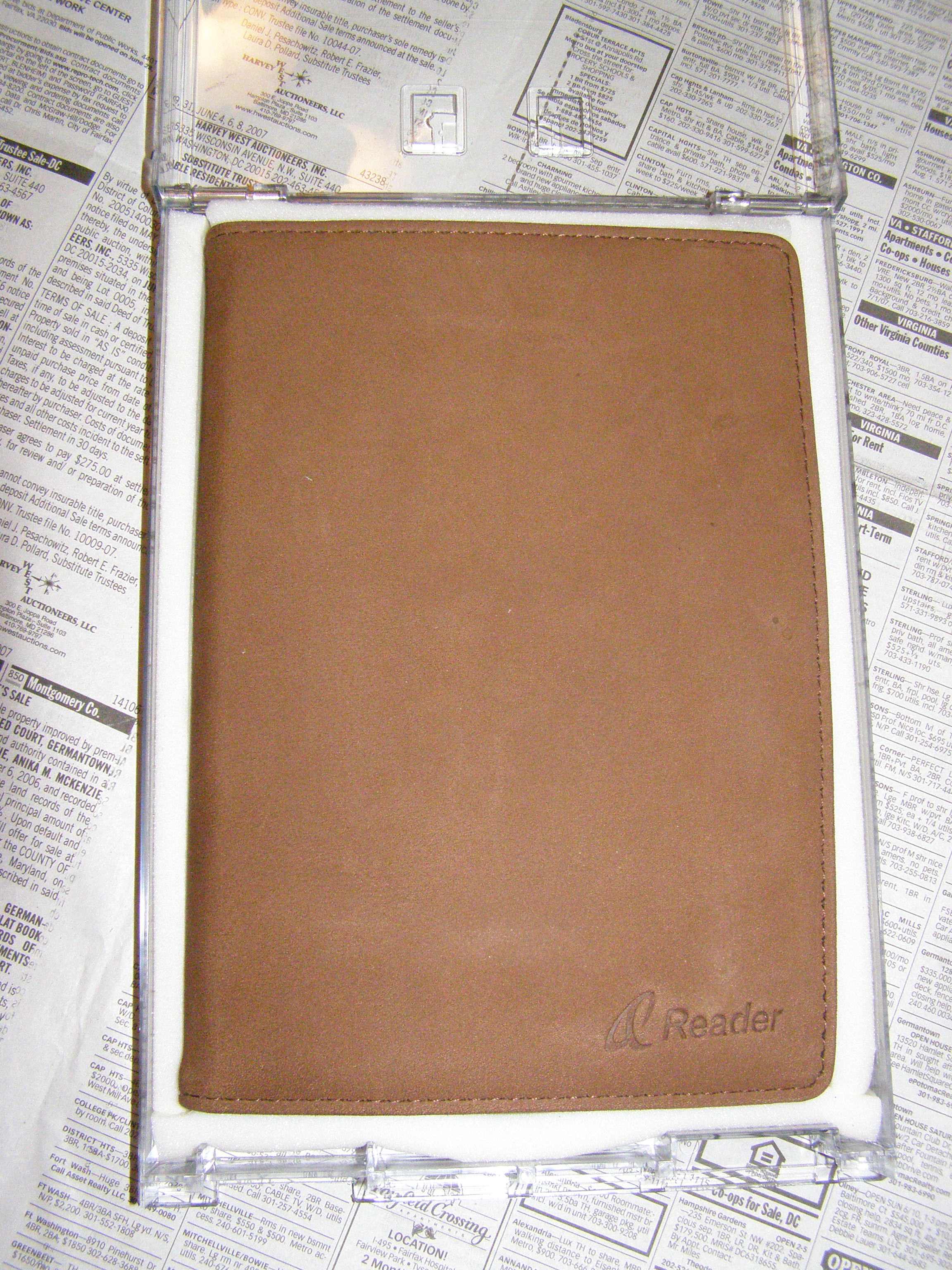

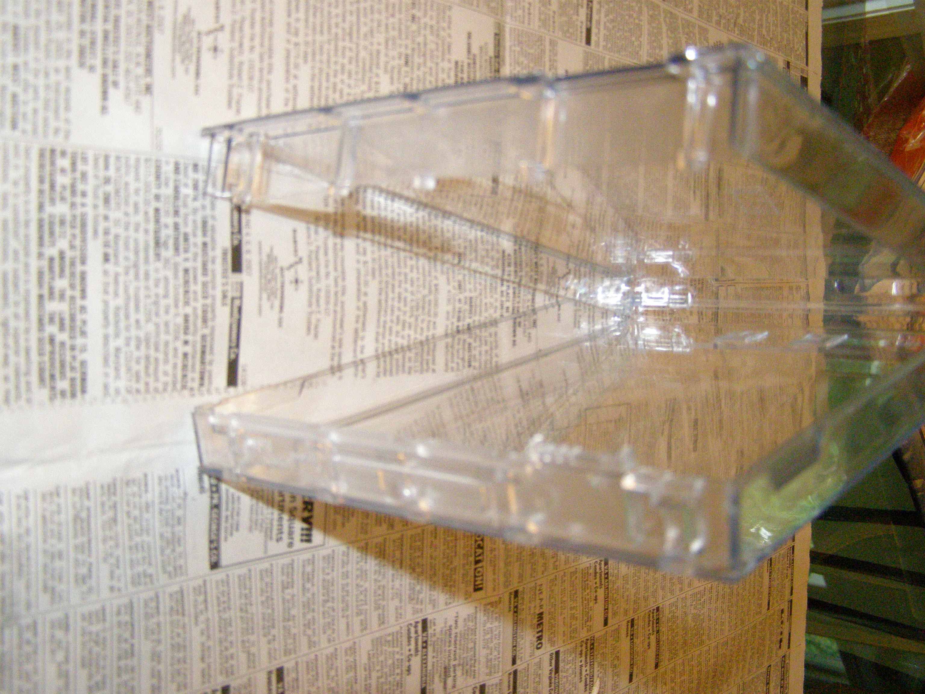

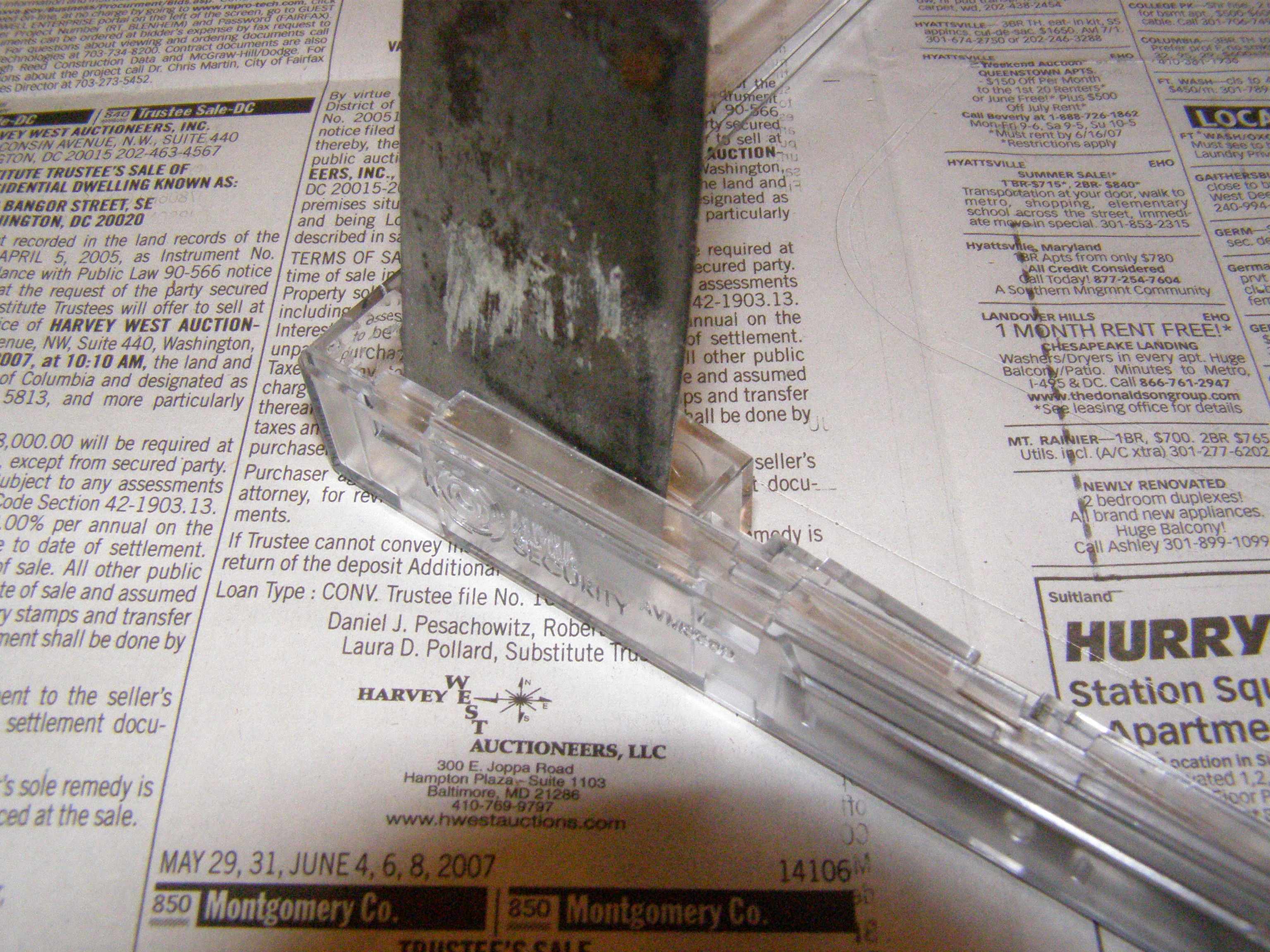

Picture #1 shows the case as it comes from Brodart. Alas, this case is designed to prevent DVD theft, and it can only be unlocked with a special tool. Fortunately it comes unlocked, and you can disable the lock mechanism by inserting a putty knife as shown in Picture #2. Just pry it up a little and shake out the metal locking gizmo. Throw that out, and you can use the latching mechanism to keep your Reader snug inside. Picture #3 shows the locking bits removed.

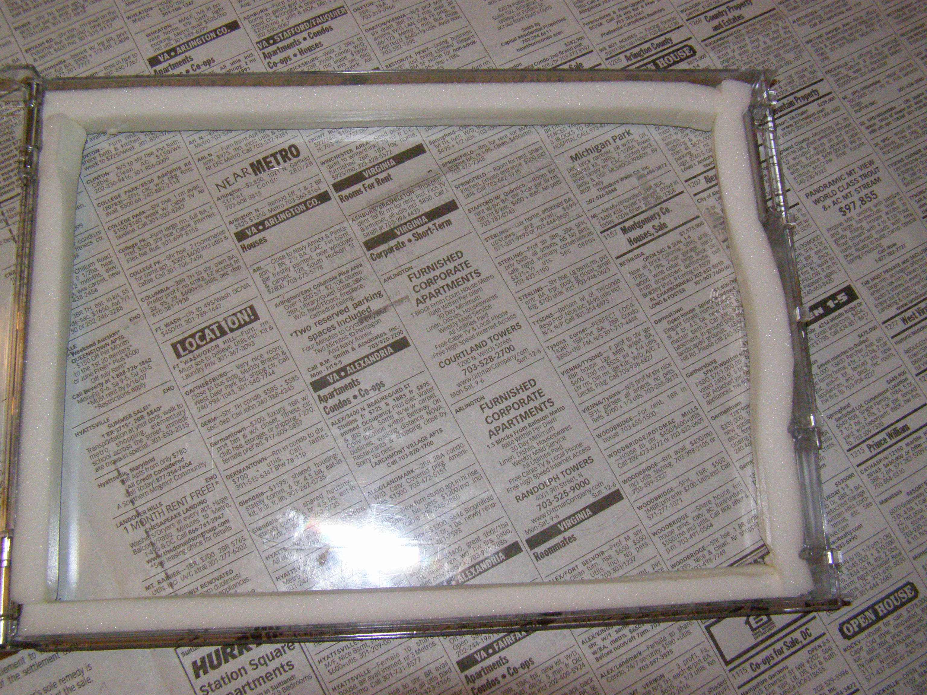

Since the reader needs a little cushioning, I got some weather strip at my local Home Depot for $2, as shown in Picture #4. You could use 1/2" weather strip, it would fit better, but my Home Depot only had it in ugly grey.

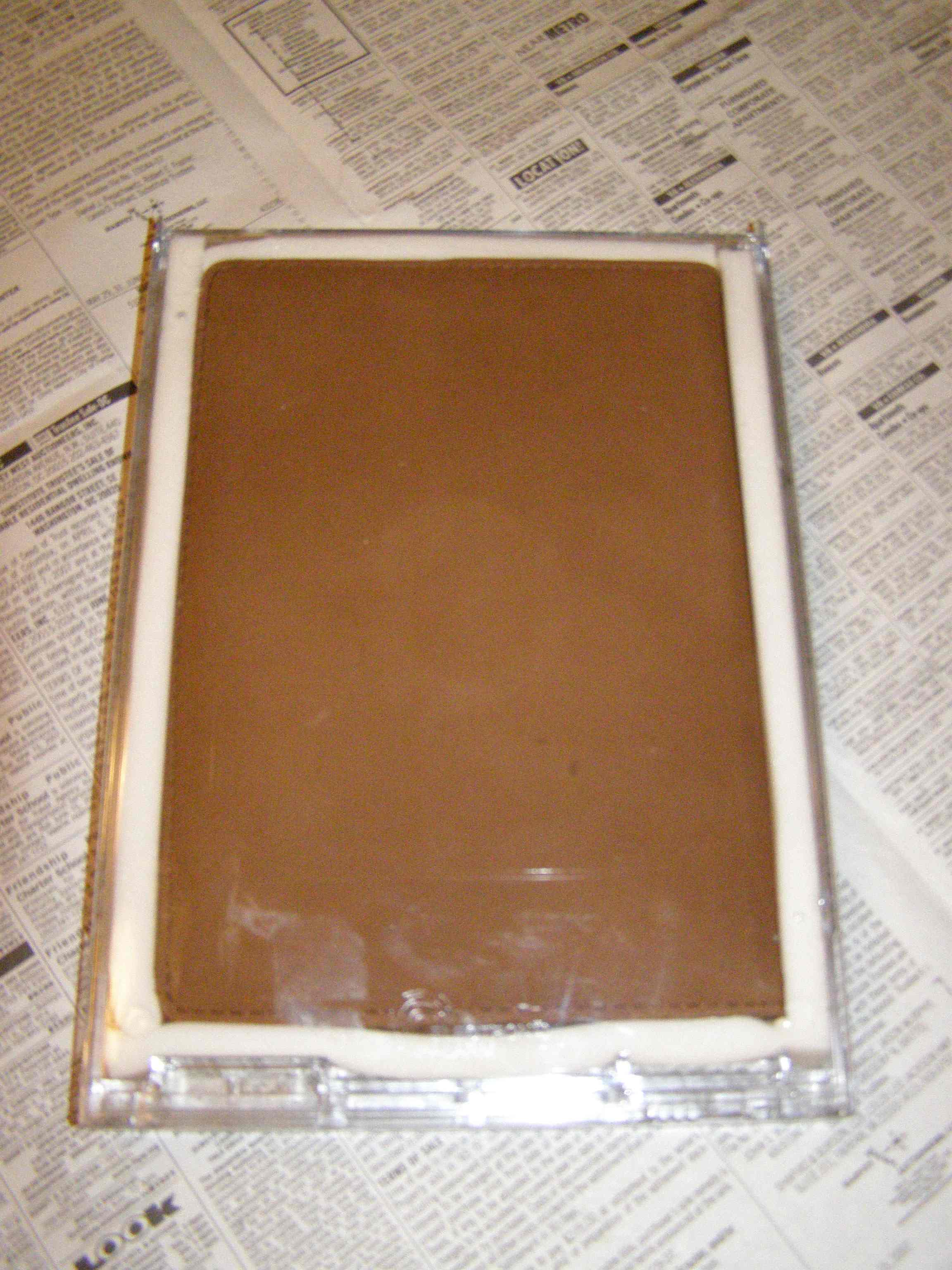

Line the inside half of the case (it slides inside the other half as you close the case) with a strip of cushion as shown in Pictures #5 and #6. Case complete.
Picture #7 shows the Reader inserted in the case, Picture #8 shows the Reader cover closed, and Picture #9 shows the case buttoned up.

I was worried about popping out the security latch, but that turned out to be the easiest part.
