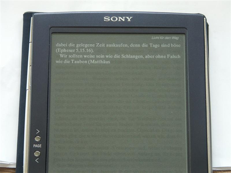

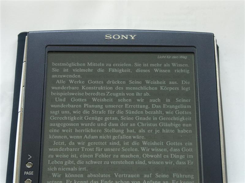

Some Pics...
I made two pictures, to show the ghosting effect.
I love to have a customizable reader now!
Thanx to the great guys of this great forum!!

Hmmm. The ghosting does seem to be significantly more noticeable in the inverted mode ....
