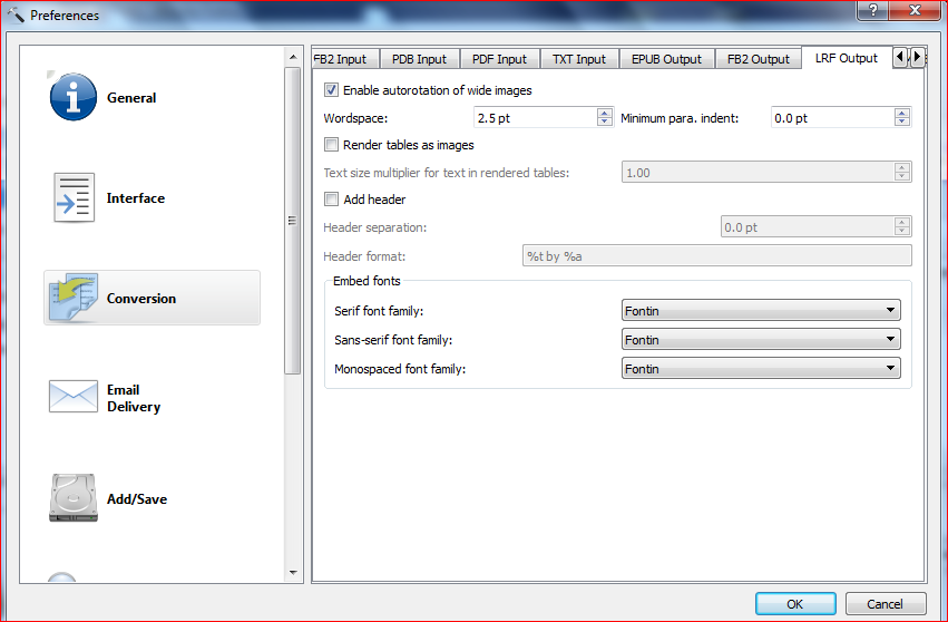

I seem to have done something wrong. I used Calibre to convert Already Dead in ePub to LRF with the Fontin font at a base of 12 pts.
The page turns are soooo slooow. I took the book off the SD card and put it in the device memory but it's still slow. Also, it stays at the one font size (which works for me but still...). What did I do wrong?
i can't confirm since i read almost no lrf files and never convert to lrf myself, but i've heard that lrf with embedded fonts is notoriously S...L...O...W... you can embed fonts in epub files too though and even just add some css to your epub to tell it to use fonts stored in the memory of your device ; see this thread for detailed instructions (and screen caps !) if you haven't tried it. i use either fontin or gentium for all my epubs, now. and it's fast.
Okay I just confirmed (as per PM) that the page turns are slow on mine as well with the converted LRF and that font. I suspect it may be the font that is at the core of it. It takes extra time to render as it is turning the page. I don't know though as I've not ever tried to use other fonts on mine.

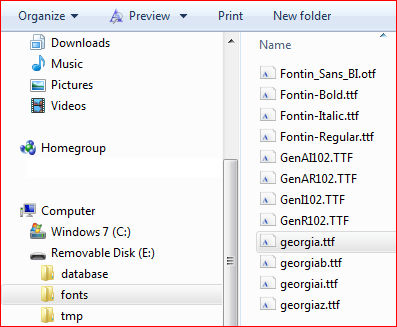

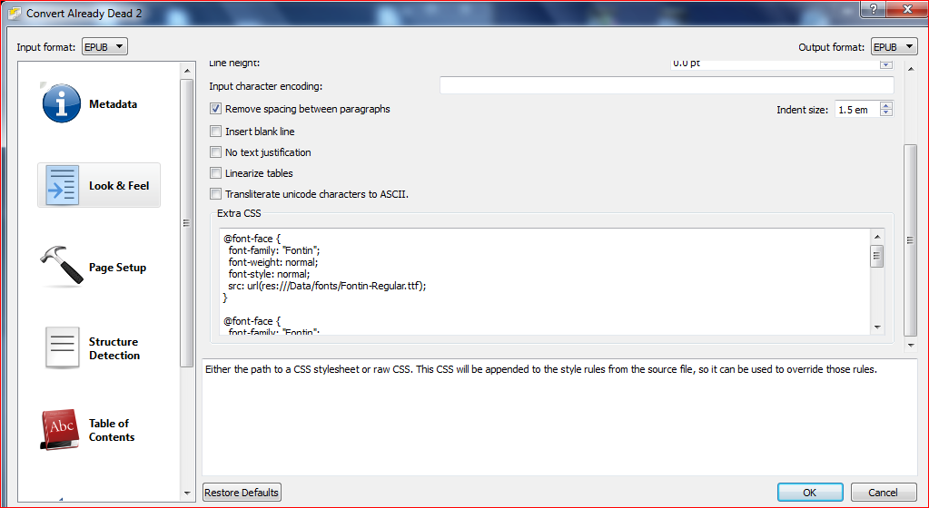

@font-face {
  font-family: "Fontin";
  font-weight: normal;
  font-style: normal;
  src: url(res:///Data/fonts/Fontin-Regular.ttf);
@font-face {
  font-weight: bold;
  font-style: normal;
  src: url(res:///Data/fonts/Fontin-Bold.ttf);
@font-face {
  font-style: italic;
  src: url(res:///Data/fonts/Fontin-Italic.ttf);
@font-face {
  font-family: "Fontin Sans";
  font-weight: bold;
  font-style: italic;
  src: url(res:///Data/fonts/Fontin_Sans_BI.otf);
Name:	css on calibre.PNG
ID:	42684   Click image for larger version
Name:	my fonts.PNG

hm. that's odd, everything looks ok to me (but it's almost 1 in the morning here so it's possible i'm missing something reeeeallly obvious...). i recommend you post directly in that thread, maybe there's a quirk related to 505s i don't know about.

I left out:
body {
  font-family: "Fontin", serif;
I added it in and still no font love.

I DID IT! A missing space was the culprit.
I had "body{" instead of "body {". Thanks all!
I would say nothing is wrong. LRF is a pig when it comes to embedded fonts. It's just slow. ePub is fine for embedding fonts as it's nice and fast. But LRF (with embedded fonts) just bogs down and makes reading not so nice.
