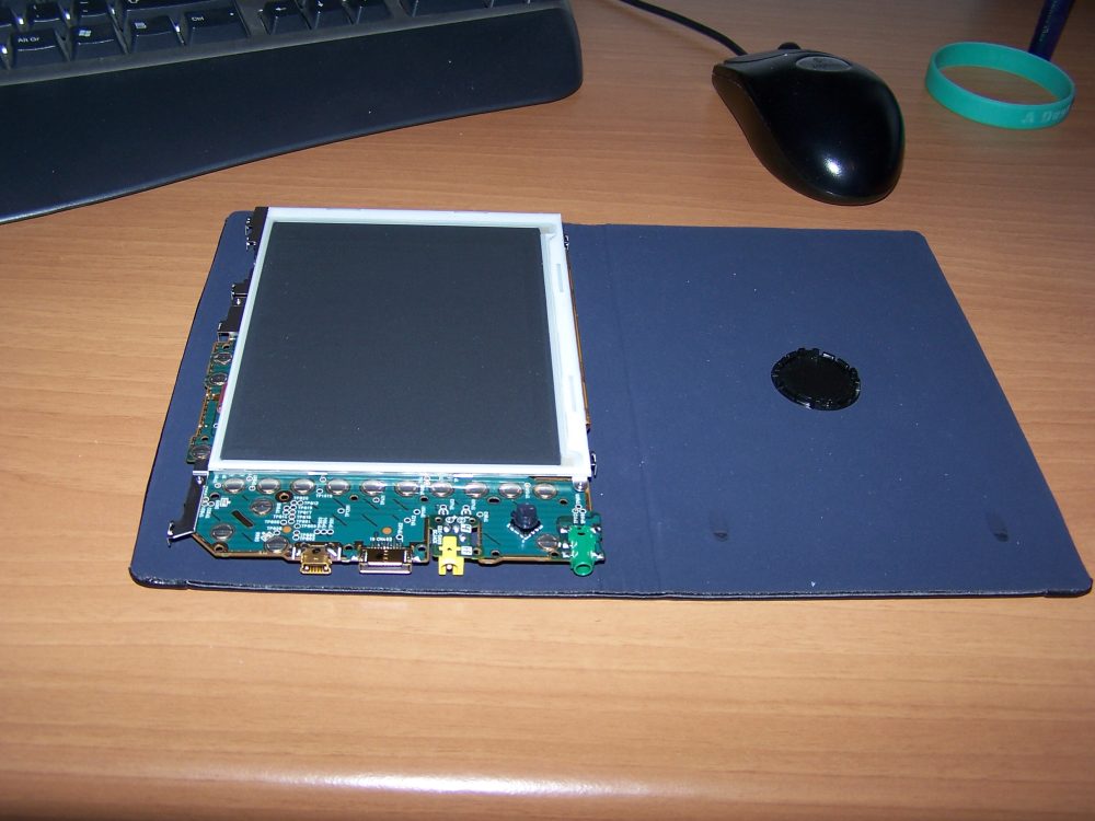

I have a problem with my sony reader pr-500. The LCD don't work very well, because the contrast of LCD is wrong. Tomorrow I will send a photo of LCD.
Thanks
Thanks
Hi PierUEAU, welcome to MobileRead.com!
You can adjust the contrast yourself but you need to open the Reader to do so. If you have guarantee I wouldn't mess with it yourself. Check the following thread for more info:
Click
diabloNL is offline   Reply With Quote

This is a photo of the LCD. I opened the Reader, and I adjasted the contrast, but there wasn't any effect.

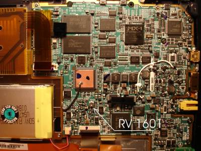

Why did you take out the whole screen? The variable resistor is direct reachable without taking it apart completely. Are you sure you played with RV1601 like in the following picture?
