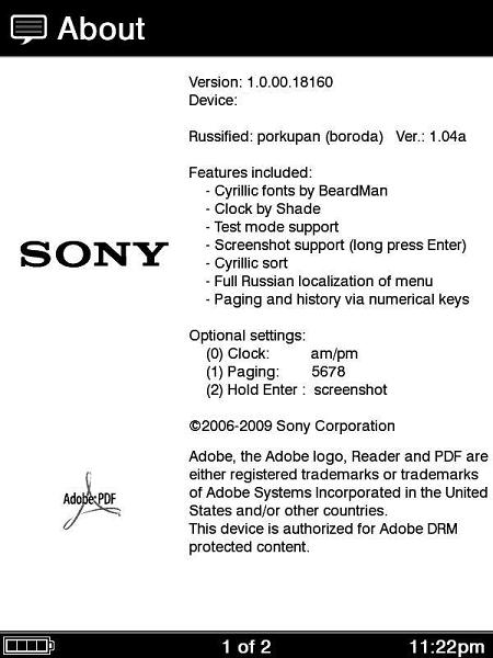

I then pressed "6" on the 300. It was at this point that I saw "5: save firmware images" and thought to myself, hmmm, maybe I should have done that first If someone has done it maybe they can post here what it does, where it puts the files etc...
The screen then changed to "Copying image files to memory" then changed to "Flashing new FSK filesystem" then changed to "Reflashing was successful. Rebooting" The whole process took ~40 seconds or so, give or take a little. At this point I looked at the screen and wondered if I had to press 9 to reboot when the unit rebooted on it's own. So no further action is needed from the user once you press 6 to start the flash process.
When the unit rebooted I saw the clock in the bottom right corner, menus were still in English, my current book was saved along with the page I was on, the menu language tab changed from having a Dutch option to now having a Russian option. And lastly the About page had 3 new options that could be changed:
(0) Clock: {24, 24-tick, am/pm, am/pm-tick, off}
(1) Paging: {5678, normal}
(2) Hold Enter: {shutdown, screenshot, none}
The "tick" options in clock will update the clock every minute, but it does not allow the cpu to enter a sleep mode and will drain the battery down VERY FAST. Without the tick option the clock changes whenever you reload another page.
That's it... It was very easy to do, and has turned a great unit into an even better one with having the clock visible, the ability to shutdown without menu hopping, and being able to turn the page from the side buttons.

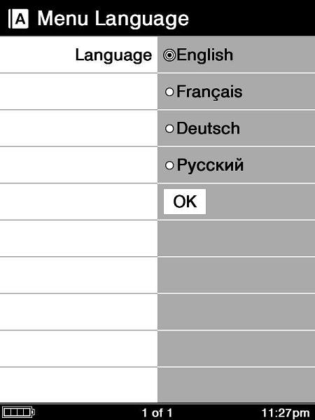

I hope this helped someone that may have been looking for more info on this process. Here are a couple screenshots to show the language and about pages.
ID:	42708   Click image for larger version
