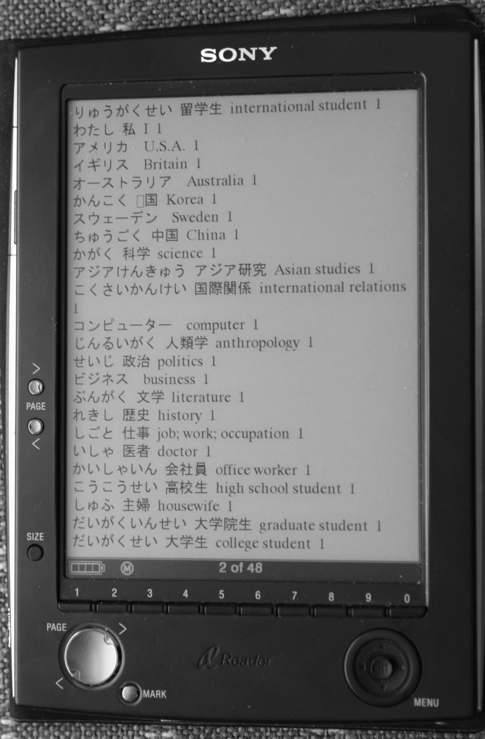

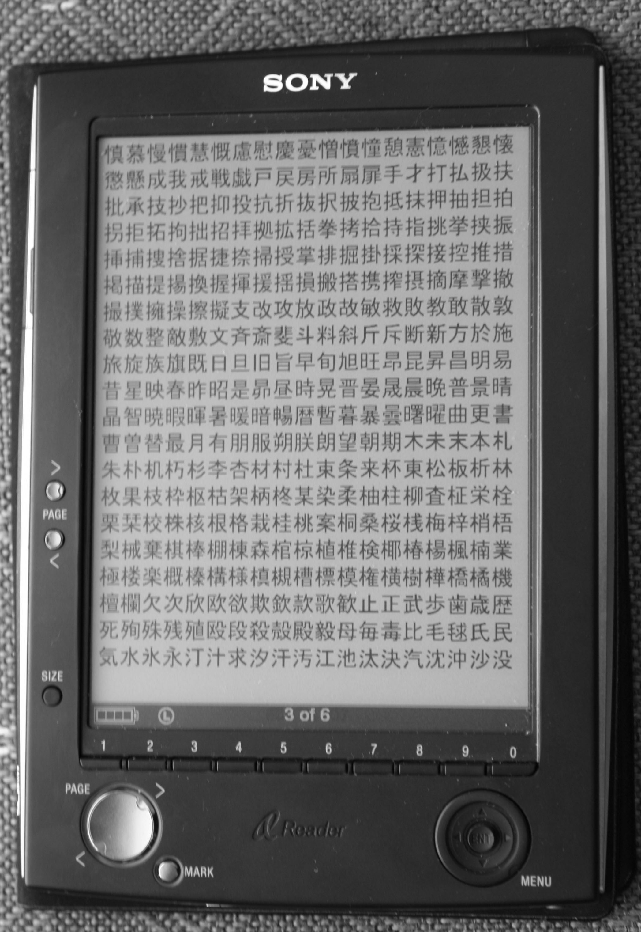

Old 05-22-2007, 03:58 PM   #73
tuktuk
tuktuk began at the beginning.
Posts: 20
Join Date: Sep 2006
Device: Zaurus
Originally Posted by each
Great job!
I have a question: is it possible to add built-in fonts for Asian language, such as Chinese. Any restrictions on the file size of these fonts?
I don't think it is possible for Chinese.
There are actually three fonts in the Reader. With the 7mb limitation in mind, you could pick the most frequent ~ 2,000 characters and put them only in one of the three fonts. It could possibly work for basic Korean or Japanese but I understand that you need much more characters for Chinese, right?
See
https://www.mobileread.com/forums/att...achmentid=2663
https://www.mobileread.com/forums/att...achmentid=2665
tuktuk is offline   Reply With Quote

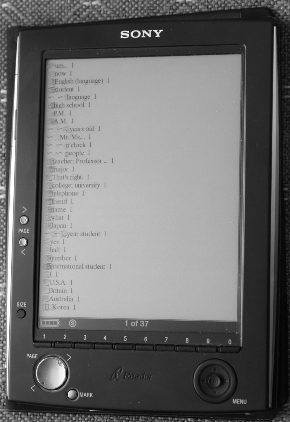

Old 05-22-2007, 04:06 PM   #74
tuktuk
Posts: 20
Join Date: Sep 2006
Device: Zaurus
Originally Posted by kovidgoyal
Just a note of caution here. If you use a font with very different metrics from the default font, certain parts of the LRF may have their formatting ruined. Tables are the best example of this.
To illustrate here is a font that has crazy Japanese characters when the size is small (other sizes are ok).
https://www.mobileread.com/forums/att...achmentid=2664
