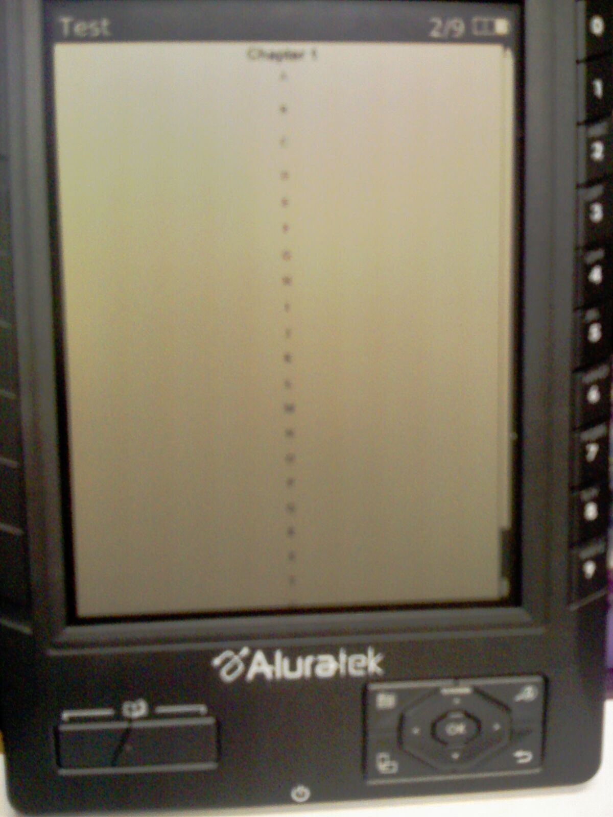

ok i tried the pdf...there wasn't a table of contents in the pdf file i think. ok i am somewhat new to ereaders so I guess i'm not sure what you mean by table of contents. thats the thing at the beginning that lists like chapters etc right? anyway the pdf didn't display correctly when i first opened it if that is what you mean. i turned on reflow then turned it off and then had to change font size etc.
i took a pic of it finally displaying all the content the way it was displaying when i opened the pdf on my computer.
i hope it helps...
i hope it helps...
I noticed the funny display issue as well.
The TOC link is under the Menu. Push the menu key and you should have 1) Table of Contents as the first option?
Kralik is offline   Reply With Quote
Old 12-17-2009, 05:00 PM   #30
hamfitz
hamfitz began at the beginning.
Posts: 35
Location: las vegas, nv
Device: aluratek libre, sony prs 650, nook
lol ok i feel stupid.
this is what is displayed on the screen once you hit table of contents in menu
1 0
2 1
3 3
4 5
5 7
left is what button you push and i think right is the page number it goes to.
