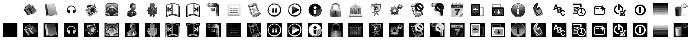

Icons V2 Cleanup & My Own Customization
Hi Everyone,
PRS Customizer 1.04 worked perfectly for me.
Only thing is I noticed some artifacts when I switched to Iconset2. So I pulled out my handy dandy graphics editor and touched the file up.
I've attached it in case anyone else wants to use it.
I've also attached my own kBookAssets.png that has a Hitchhiker's Guide to the Galaxy theme to it, if anyone else wants to use it.
Keep up the great work,
This is a really useful piece of software!
Beny
ID:	40723   Click image for larger version
ID:	40725   Click image for larger version
