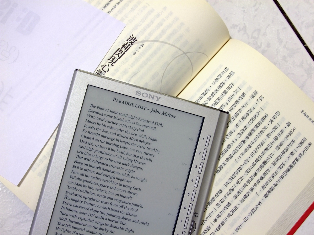

Hi PortiaDaCosta,
You'll just have to get used to e-ink being pretty poor in contrast. Much of my posting history on these boards is dedicated to pointing out how overrated it is. The most depressing part is that the 505 is about as bright and contrasty as electrophoretics currently come. There's hope around the corner, but for now we have to make do with e-ink. When another user posted a snap of his PRS-300 next to a book and a piece of white paper, I decided to do so also. I'll post it below, even though it's not a great photo (just a quick shot with my compact digicam).
On the upside, if you choose decent Latin-based fonts, text can remain readable to quite small sizes. I used to try 10-11pt, then went to 9pt, and now I tend to prefer 8-8.5pt for most of the books I make. The copy of Paradise Lost in the picture was done with Garamond Premier Pro Caption at 9pt and is quite pleasant, even if imperfect. For long block body text, I tend to use Karmina which is narrower and well-adapted to smaller print, and I'll post a photo of that when I get a chance.

Many thanks for posting those photos. They give me a v. accurate picture of what to expect from my PRS-505.
As I said in my first post, when I first got the reader, I was alarmed in case I'd got a faulty one. But now it's easy to see that it's perfectly OK, and that's just the way they are.

Glad to help. The web could use some more realistic photographs showing how e-ink compares to paper, since even bad pictures are often much more honest than words when it comes to markets like this.
I'm not a fan of e-ink in general, but I can tolerate it for a low-power device that I use for casual reading. I can't wait until superior alternatives come out though. I'm even willing to build all my own formatted ebooks for it, albeit only in English for the time being. I can't make very readable books in my second language (Chinese), despite a lot of effort and experimentation. I've attached a pic of some Chinese text in one of the more ubiquitous Chinese fonts next to a printed book that uses a related typeface.
If one can dismiss the hype though, ebook readers can be pleasant devices to own and use.
Addendum: Though not a scientific test, casual observation of the real-world results through photo software shows the following brightness/darkness levels of the 2 media compared. The numbers are not the same as reflectance, but based on white/black values set by a white/black/gray card used in the photo.
Paperback:
Brightness 95-98%
Blackness: 19-23%
Range: 5.2:1 (high); 4.1:1 (low)
PRS-505:
Brightness: 74-76%
Blackness: 30-35% (bold header), 40-55% (admittedly weak body text).
Range: 2.6:1 (high); 1.3:1 (low)
Like I said, they're not scientific numbers or lab data, but they're interesting food for thought anyway.
