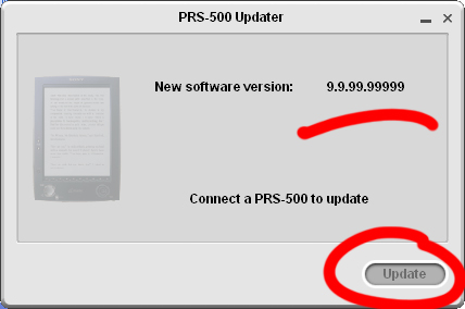

Thank you for taking a look and trying to offer some help. To simplify, I'm trying to trick the updater. Can a flash be done via SD card?
Any ideas out there?

have you tried a software like windows enabler to enable the update button ? This has worked on my terrartec iradio

I tried other systems, and different USB ports on those systems, without any luck. I also used the intriguing "Windows Enabler" tool, but it too was unsuccessful at enabling the update button.

Unlocking the update button isnat all that great, all i did is edit the XML, if you press it it does nothing becasue it cant see the reader( hence why its locked in the first place) although the sony library software sees the reader (although comes up error) and its in device manager.
