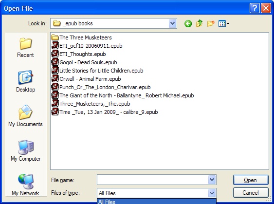

Originally Posted by mikelv View Post
Hm , just to make sure I understand exactly what you mean: You go to the Firefox "File/File open" menu, select the wanted epub-file, click on the "open" button. In the next step the epub-file is not displayed, but you see another Firefox dialog? Could you please send me a screenshot of this dialog?
Or perhaps ericshliao may be referring to a filter for EPUB Files within that File Open requester.... Click image for larger version
Name:	Files of Type-needs-epub filter.jpg
In addition to All Files, HTML Files, Text Files, Image Files, XML Files.

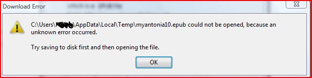

Hi Dale, I just tried it but couldn't reproduce your problem. How did you open the file in Firefox? Did you download it first and opened it then via "File/Open file"? Michael
I had no problems downloading this ePub to a private folder, and then opening it via Firefox "File/Open file". The TOC looks a bit odd; the titles for Books I, II and IV *seem* to be the name of the image in those Books and not the actual name of the Book.
*edit* But when I went to download and open it directly from Firefox , it now shows "Open with" and defaults to Mozilla Firefox. I left the default to Firefox and got the following error
Hope this helps.

Originally Posted by kenmark View Post
I had no problems downloading and then opening this ePub via "File/Open file". The TOC looks a bit odd; the title for Books I, II and IV *seem* to be the name of the image in those Books and not the actual name of the Book.
Hope this helps.
Thanks, I already know about this. It does not download automatically because the webserver sends not the correct content-type. I've already talked to Jon who uploaded the file. He will change the content-type.
What happens, when you select "Mozilla Firefox", I don't know. Normally you shouldn't see this dialog.
mikelv is offline
I added a screen shot of the error, I'm not sure if you saw it.
Hope this helps.
This is exactly the error I got.
Sorry, bad formulation . Yes, I did see your screenshot. What I wanted to say is, that I don't know what this errors means. But because you normally don't see the dialog where you can select "Mozilla Firefox" as the download starts immediately, I won't analyze this problem.
This seems to be what happens if the browser is using the extension only to determine what program to use. I had two choices, one was my browser and one was Sony's ebook library. The Sony ebook library worked fine so I should expect the browser should have worked fine as well, but it didn't.
