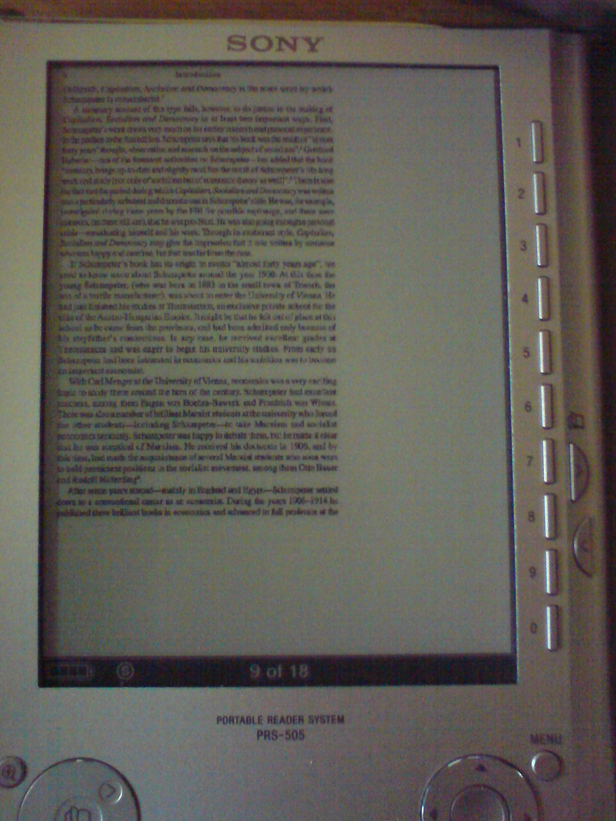

My PDF>LRF conversions for PRS-505 tends to create portrait documents that are pushed to the left, with a big blank space to the right. Other than that, the formatting is great. How can I correct for this?
See attached.
