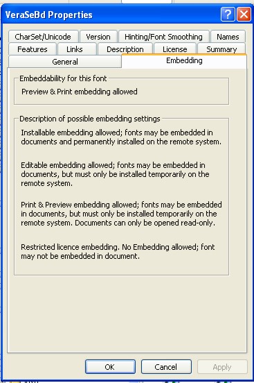

Okay well all the paragraphs say it's allowed.... last paragraph says this. Restricted license embedding no embedding allowed, font may not be embedded in doc........ well I just checked on Arial and it says the same thing and arial can be used so something is just plain screwy here....

The top area of the box inside an area that says "Enbedability for this font" is a single line that described the properties for this font. The following box provides descriptions of the four embedding conditions that may be in the top box.

OK, first I have enclosed a screen shot of the embed property area. The top box is what is allowed with this font and the bottom box is a description of all possible descriptions in the top box.
Now about setting a base font in BD. Open BD and select Make e-book|Sony Reader. On the top are three (3) tabs, select "styles" and you will see the settings for each element in BD for Sony Reader. This is also where you can add external fonts to the BD arena. I save my selections under "default" so that they will load each time without my having to think about it.
As for listening and calling people by the form of address they request ....
